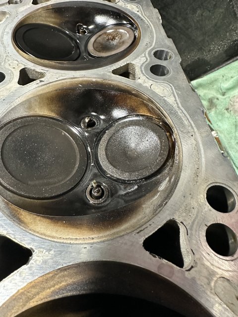

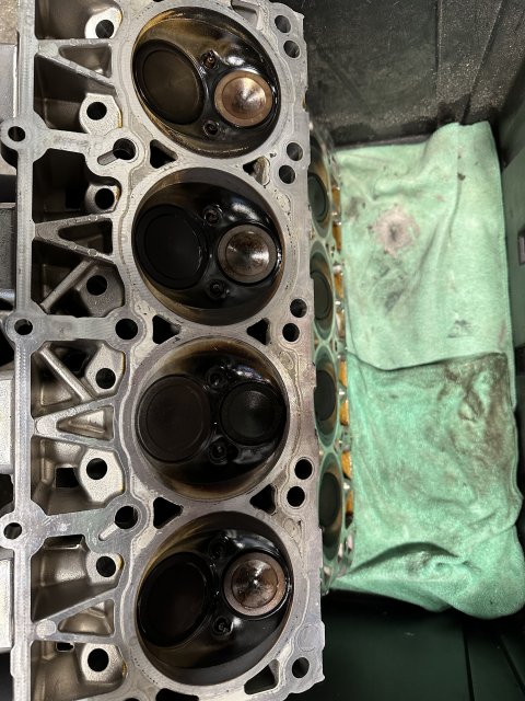

From the photos sent here, he had number 4 fail not number 2? To me it looks like heat in that cylinder caused this meltdown. Definitely not a defect.

I'm not sure. Shop said cylinder 2 but didn't have it front of him at that minute. Maybe someone else can confirm. If it's not cylinder 2 then very possible the injector actually did fail and we'll find that out shortly. *edit* I guess based on a diagram, it is indeed cylinder 4.
7,938
6,819
I
If injector failed plug would show it.

Here are the pictures of the heads. Tough to tell from an image the plug condition. Hater can take a look for himself as well.
