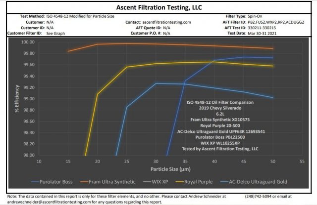

What's interesting about the "XP" versions of the WIX filters is they "open" them up, presumably to allow for greater flow as they get older???
When I saw that, I stopped using the "XP" versions of WIX filters and went back to the normal versions.

Without an efficiency rating, the micron spec is pretty meaningless. 99.9% @ 20 is the best I've seen. This would be something like 50% @ 5-10 microns. (Don't know where the Wix went on the graph.)
The scaling on this graph is a bit misleading...
The vertical axis being only 2%...

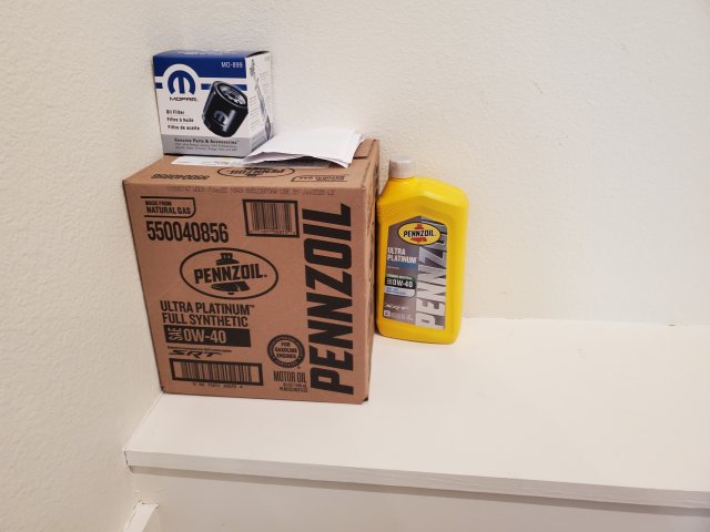

Great thread and information. When I got my car they basically threw in 10 Mopar oil changes (think they were $60 each). I have one left and decided I'm doing the oil changes going forward. Went to local dealer here and they expensed my last Mopar oil change and gave me the oil and filter.
Any issues with oil cooler cover plate removal and reinstall? The tech who always did mine made it look difficult so I'm a little weary. I know brace with wrench while loosening oil cooler plug, etc.
Have a couple more months until oil change just trying to build up my reserves again after the move.
Appreciate all the info.

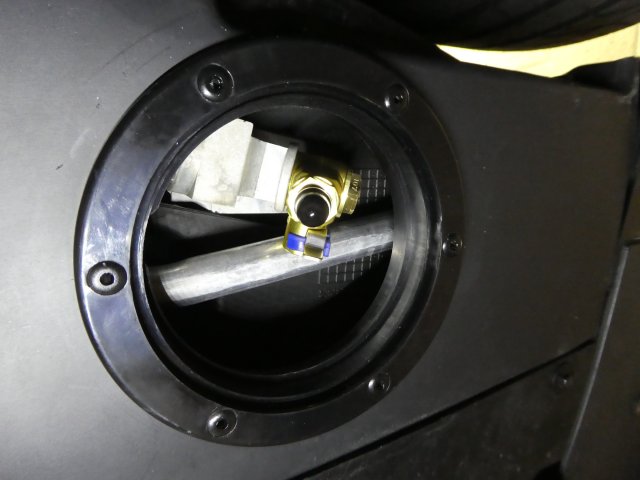

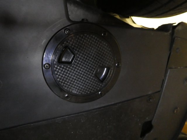

did this on mine for oil cooler drain access - saves a lot fastener R&R as noted above.
