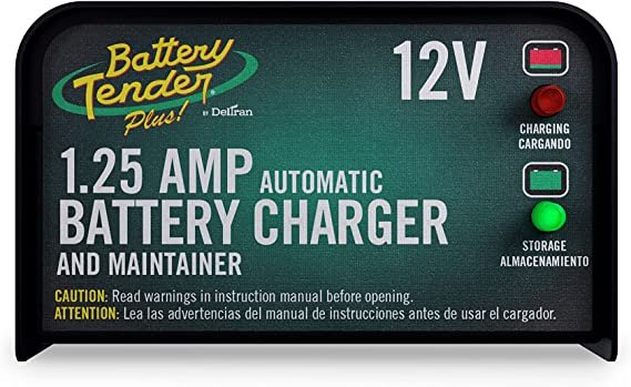

This is the one I have used both on my Terminater and Cat for years without a problem. I check it on a regular basis with my DVOM and it goes between 13+V and back to 12.7 V. It works on both wet and glas mat batterys
used an even older model of that for many years, then demoted it to one of the stores for the forklift battery. Still going strong.
Demonic Cat
2,204
4,078
#70
Thats the ticket. Dual type charger/tender. Lots of people wonder why absorbed glass mat (AGM) battery won’t keep if put on wet/flooded type. The dual type is the way to go.

And ideally with desulfation.
