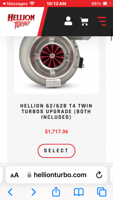

Twin 62b package is the one I’m looking at, quick spool, billet wheels, and good bearings.
And personally I think having a ported blower, especially doing the outlet ports along with inlet especially with ported heads will just help increase flow.
That’s a good choice.
