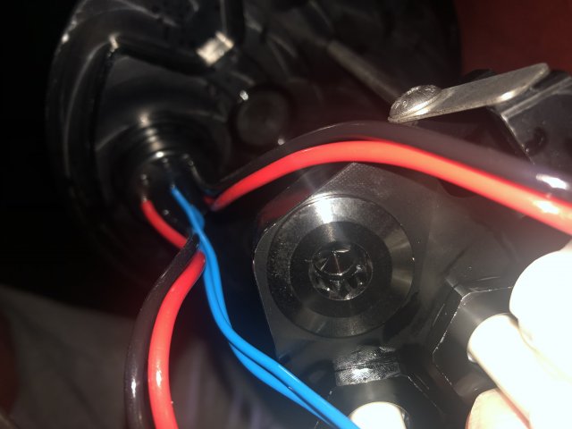

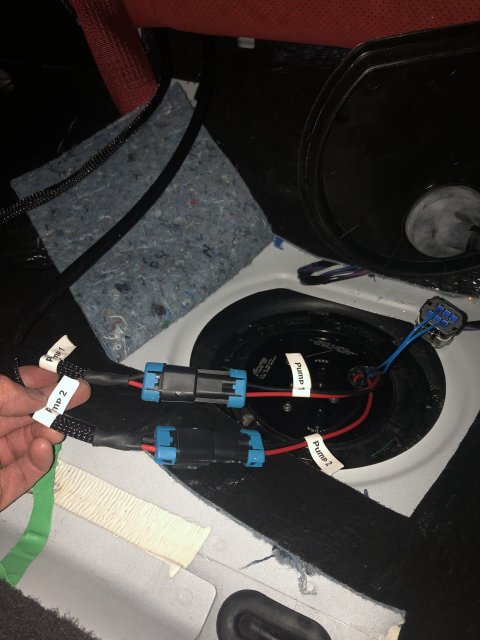

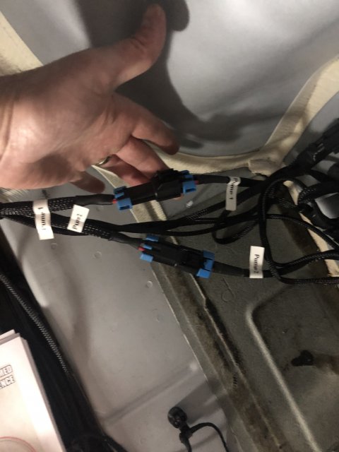

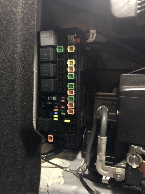

I’ll check and listen, but how can it be wired backwards? I can only see one way to wire it.
power on corner post of fuse panel
2 grounds on factory post beside fuse panel

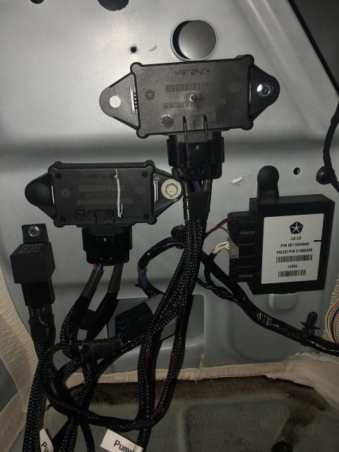

Fist and Second fpdm and y harness only go together one way I’m pretty sure
pump 1 and 2 wires clearly labeled all the way to the hat.
wiring connector on the hat
am I missing anything?

I stuck my ear right to the hat with my wife doing key cycling and they’re definitely coming on but I can’t say I hear any fuel moving?

Checked the wiring again. Seems to be correct. Excuse the mess, I didn’t secure it all down yet because I wanted to make sure it was working first. The primary fpdm is the one with white line on it.

I did at first pull the relay and tried to crank it to relieve pressure. Maybe its gone bad somehow? Both 30a fuses are good.
