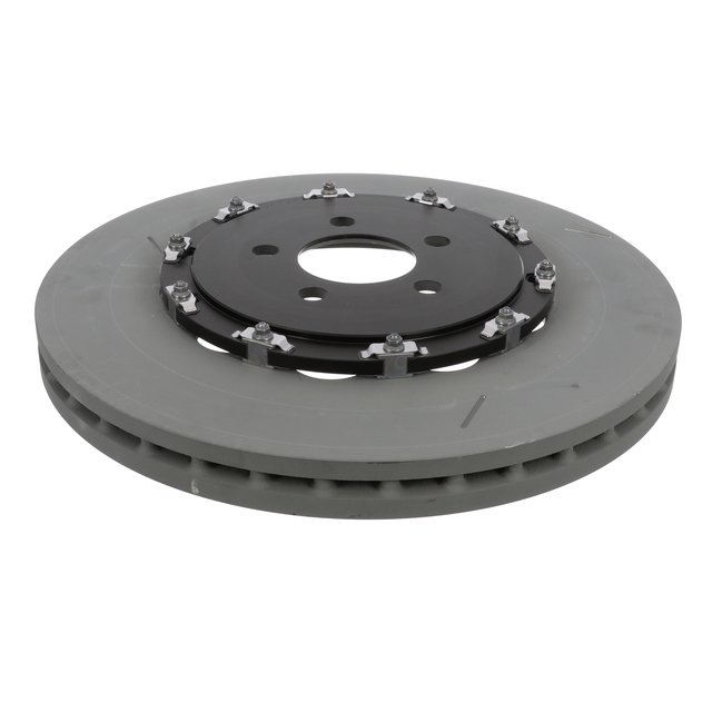

OEM Rotor
- “There is as much energy tied up in a snub from 65 to 60 mph as there is for a whole stop from 35 to zero. So the faster you go, you have a lot more energy in your speed. Since the brake system takes all that energy and turns it into heat, the heat is transmitted to the rotors. So a bigger rotor has a bigger area for the heat, or more thermal mass. More ability to absorb the heat.”

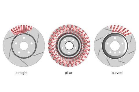

- Pillar Vane Rotor

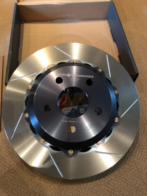

Demon Performance Rotor (Girodisc)
- The primary purpose of the Girodisc system is to reduce unsprung and overall vehicle weight. "Reducing the unsprung mass has the additional benefit of improved suspension performance, resulting in enhanced ride and handling."
https://www.girodisc.com/Technical-Info_ep_45.html
- The secondary purpose is to increase the ventilation and cooling capacity of the brake disc while retaining its original dimensions.
- Front Rotor is 6.6lbs less per rotor
- The disc is made from cast iron
- Curved Vane Rotor
- "Decreasing the mass of the disc has a great benefit due to the reduction in rotational inertia. This will allow more of the braking force to be available to decelerate the vehicle, not the disc."
- "If you plan on using stock pads, plan on stock braking performance, but with less overall fade from repeated heat cycles as our rotors cool down much quicker due to the internal design." Demon Performance, Nate

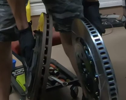

Comparison (old stock rotor) (Demon Performance rotor)

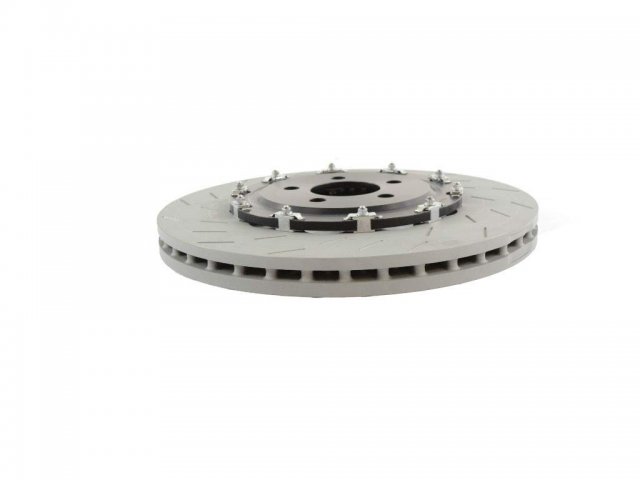

New OEM 68184587AE
Old OEM 68184587AD
Demon Performance

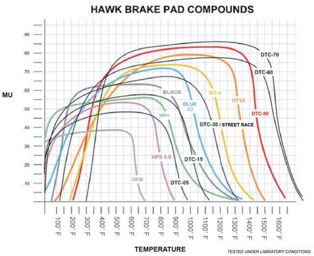

RST Pads

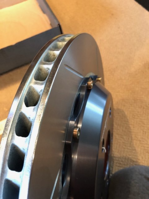

I notice that the DP rotors have less material between the vane channels and the wear surface. Would their longevity be similar, due to harder material and what, on first sight, seemt to be FAR better cooling setup in the cooling vanes? (more of them)
So curious.
Also, curved vanes lead to reduced chances of radial cracks developing, as Porsche discovered, with their cross-drilled racing rotors.

I notice that the DP rotors have less material between the vane channels and the wear surface. Would their longevity be similar, due to harder material and what, on first sight, seemed to be FAR better cooling setup in the cooling vanes? (more of them)
So curious.
Demon Performance recommends changing their rotors at 32mm.
OEM minimum is 30mm per the service manual. After, 61,000 miles, I’m currently at 31-32mm on OEM and plan to change due to an outer lip on the rotor affecting pad contact. Both start at just over 34mm. Both are cast iron discs.
Looks like the main differences are mass, thermal capacity, and vane structure.
Mass - DP rotors have less, OEM has more
Thermal Capacity - OEM has more capacity
Vane Structure - arguments are made for both pillar and curved being better for cooling

Hawk DTC-70 Pads
