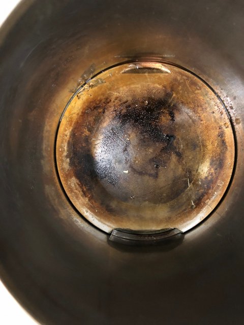

On the 5.7 and 6.1 HEMI platforms (and especially the 6.4), the ring lands were a problem. .
I can attest to to 6.4 ring lands....

Was this on a stock engine, modified, with or without boost?
No boost. Just ported heads, long tubes, cam and tune. Stock internals.

@Stl376 - that looks like the exhaust side of the piston. From memory I think it was usually the intake side that broke on supercharged applications at least. Looks like in your case it just got the ring hot, probably from running a bit lean.

Interesting that the ringland failures were favoring a certain part of the piston. I find it very unlikely that the ring gaps were all in that orientation from the factory and remained that way throughout the lifespan of the engine. Would be very interesting if that was the case.
Of course I’m assuming that the primary point of failure would be where the gap is sealed and the 2 ends are fighting for space.
Seems intake side was prone to over heating.

If I'd had time I'd have pulled all the pistons out, but I was pressed so just boxed it up and shipped back to Mopar for core once we found the one disintegrated. I received some piston/rod assemblies from a performance shop (3 assemblies) from a failed engine. They didn't give me details on what failed, but @16GoManGoHC2 has experience testing parts failures so I shipped two of them to him to do some catastrophic tests on out of curiosity. I also sent him what was left of my #7 cylinder piston. Piston tops looked ok on the three test subjects, but had some scoring on the sides.
Turned out the piston assemblies I sent him were bent (granted not from my motor but AJ has mentioned bent rods more than once now). I kept one for myself as a souvenir and when Mike told me the others were bent I checked the one I kept, sure enough it's bent. The piston from my engine exhibited very similar wear characteristics on opposing sides as the assemblies I provided with bent rods. Mike's experience suggests the rod failed and caused my piston to fail. All just educated theory though really.
Had another shop reach out to me last week. Three Hellcats and a Demon all broke #7 and his analysis showed rod issues so they now recommend a piston/rod upgrade after 800rwhp.
In hind sight, an autopsy of your old engine may have yielded some information that could have helped you answer your own question, especially as it pertains to your specific use. It would have been beneficial to inspect the other 7 rods to see if any were bent/stretched and if so, why? Due to excessive cylinder pressure possibly? Detonation? RPM?
Combine that with your discovery of broken spark plug ground straps and the answer may have become more evident and less speculative.
