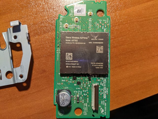

Ironic, indeed! Any insight into where the antenna trace might be on this card? (I take no credit for the photo, it's from one of the jeep forums):
Based on the integration manual's drawings, my first guess is just above the upper right corner of the main AirPrime heat spreader.
Could also be a multi-layer card, with the antenna inside. Ugh...

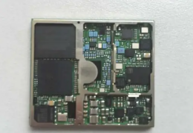

If you wanna get super detailed, here's a shot of the inside of the 7552 module with the heat spreader off, courtesy of the FCC:
