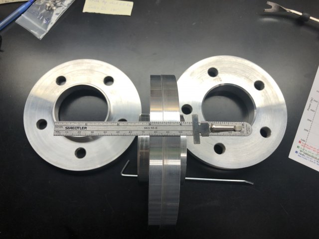

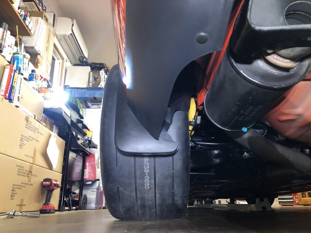

View attachment 12791 I still can’t take a hammer to my car, my 315/50-17’s will just see track duty and I doubt anyone is going to notice 12 mm of extra stick out from the spacers I made so they don’t rub the rib. Nice write up though
Nice! How big are those? 12mm? make them yourself?

View attachment 12791 View attachment 12792 View attachment 12793 View attachment 12794 View attachment 12795 I still can’t take a hammer to my car, my 315/50-17’s will just see track duty and I doubt anyone is going to notice 12 mm of extra stick out from the spacers I made so they don’t rub the rib. Nice write up though

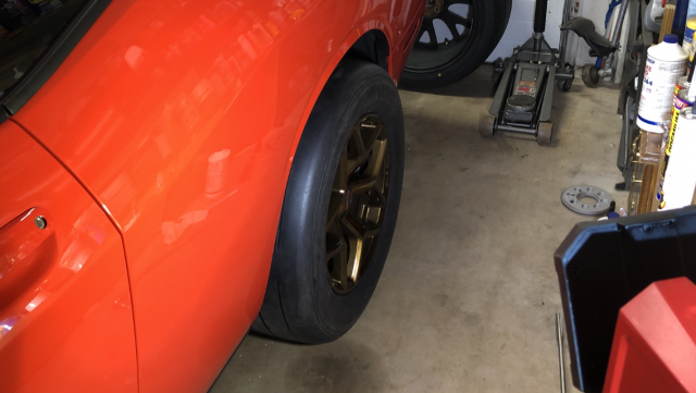

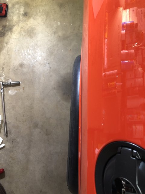

Do you have any side pictures to see how much it's poking out? I can't justify a hammer to my car as of yet either, but I'd like to run 315s too!

Started with 11 mm, they rubbed when cornering and upon being aired down to 18 psi in straight line so made another set at 14 mm. I drew the sketch, machine shop buddy made them for me. He’s making another set now for a member, $160 shipped. Could probably get him to make more but need to know quick.

Would Not exactly be pretty on the street but I don’t plan on ever running them on the street. Veteran track guy told me to just run them on the track, get them seasoned with track prep and not run them any where else, not even back and forth to the track for best performance and longest life. Going to try that this season
Yeah I drive my ET Rs on the street sometimes, and my OCD would drive me crazy with that much tire poke. One day I'll just have to man up and grab the hammer! I have these exact same wheels too. They are a 10.5 wide with 27 offset IIRC. I might switch to a 10" wide wheel with a 30 offset (Weld/Forgestar), I think they might help with the 315 better. Less hammering maybe, lol.

Is that rib the only thing in the way of fitting 315/50s? Those are Darkstars which are 9.5 inches wide, that enough wheel for a 315 tire? I'm running the racestar recluse wheels which are 10.5 wide with a 27 offset. Not sure if I'd have to hammer more or not. I know others have hammered and ran welds (10" wide 30 offset), just not sure from wheel to wheel how much of a difference it makes, especially how much more hammering might be required.
I take it removing that plastic section is a must (since the rib is in that area)?
You recommend any specific hammer for this job?
You have any side profile pics of tire poke if any?
Thanks for sharing the pics! I really want to fit 15s, just not too crazy about hammering, lol.

Non taken, like said, I wouldn’t run them on the street this way, don’t like the “stick out” look myself, but before I get the hammer out I want to be sure they do for me what I want, I’d hate to hammer my car and regret the reason afterwards.

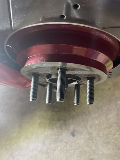

Good point, Yes, longer studs are required, I upgraded to ARP studs cut to a custom length so I could use stock rims as well with OEM looking deeper nuts or open ended nuts at the track if needed, have ARP nuts as well.

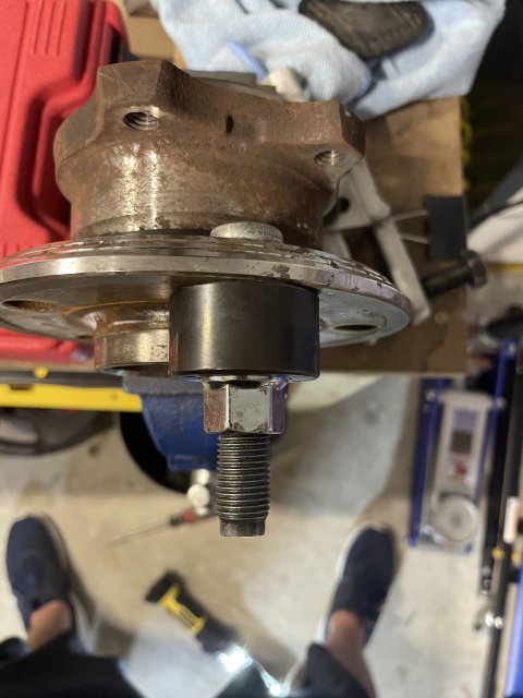

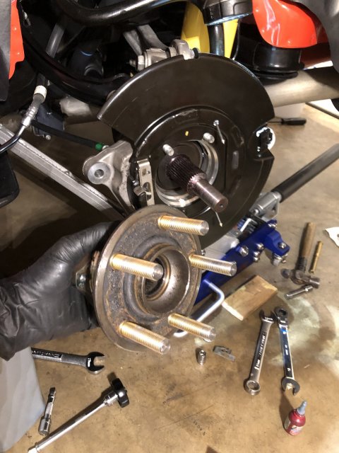

@16GoManGoHC2 how on earth did you get the e socket bolts out without removing the axles
3,688
8,702
Use a 1/4 drive E socket on wobble end extension, put the nut on the axle and push the axle in compressing the CV which gets the hub out of the way enough to get the socket on the E headed bolts. Don’t forget to tighten them first upon reassembly or you’ll be taking it back apart to tighten those same bolts. O, and dont forget to put the push nut pins that hold the E brake shoes on as theres no getting the one in after it’s all bolted back up. Don’t ask how I know both of these tips.

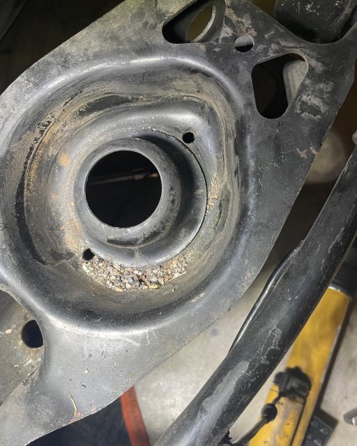

my back fucking hurts had to take the knuckle out to get to them. Only have 3/8ths and they were thick boys. One side done. Also did new isolator cups as well. Will be hitting tool store tomorrpw for 1/4ths and wobble heads

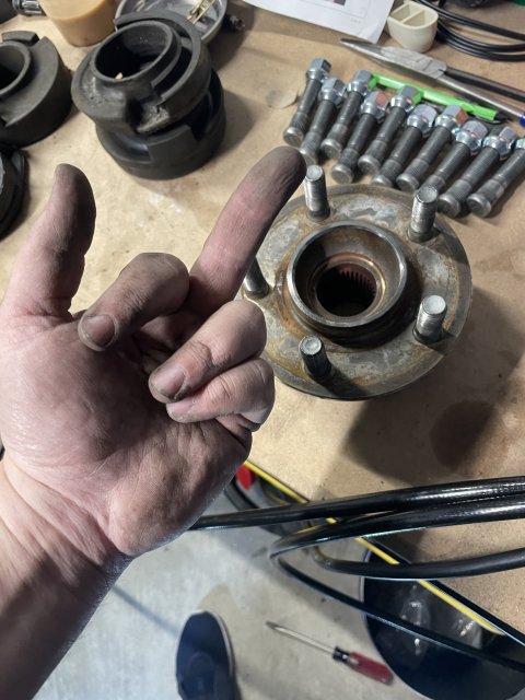

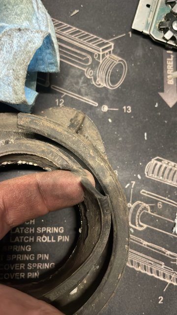

Think I found the clicking issues. Also my back has never been happier.
