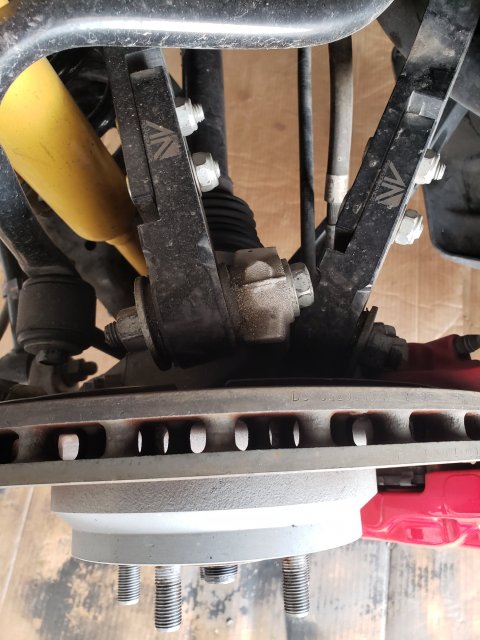

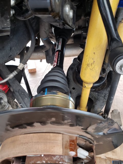

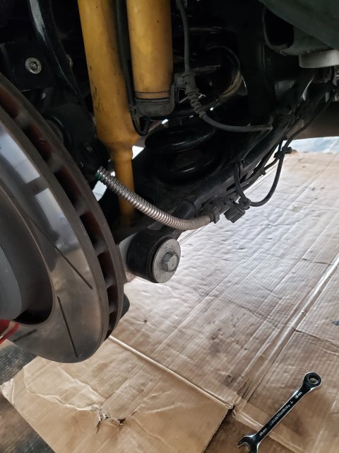

You unbolts the upper control arms, trailing arms, sway bar, knuckle, alignment bar and come out the side 20230924_121053.jpg 20230924_093117.jpg 20230924_093057.jpg

Doing it both ways it seems to be faster dropping diff
16,880
52,880
It seems less invasive to me, also avoids alignment possibilities
