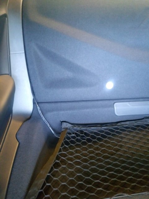

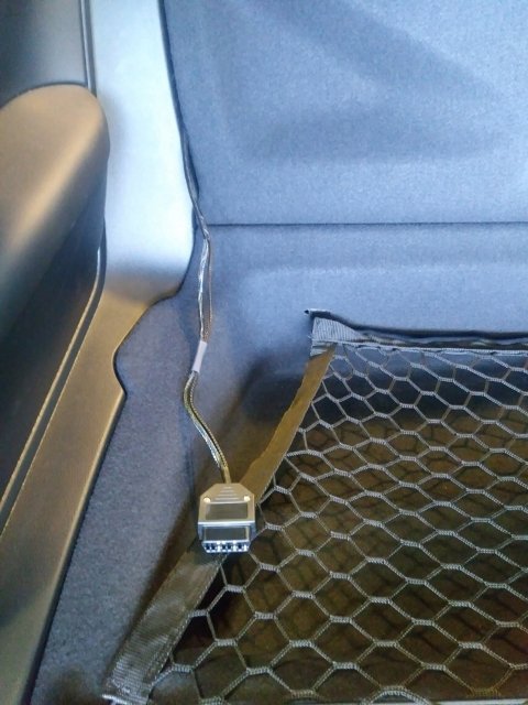

Cake. No wires across my Lap when data logging.. Z automotive Double Bypass Cable.

that’s the way to do it! Hell I copied your design!!

Do the Z automotive in the truck, I did that and extended the wiring. Works without tearing the dash apart.
View attachment 70660 View attachment 70661
This is what I've done also.
Bought a 15' USB 3C lightning cord and the Z Auto trunk OBDII relay, and snaked it through the rear seat delete like the other member shows above.
Had to buy a USB C to USB connector due to the age of my laptop, but no signal worries or delays in either logging or writing tunes.
