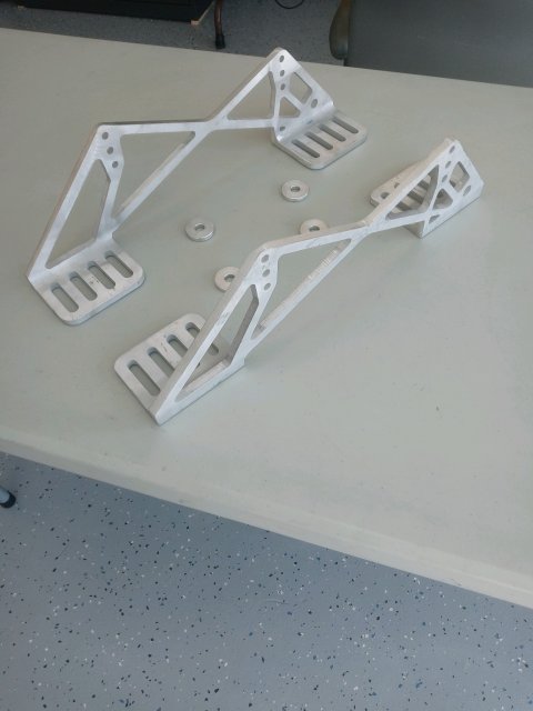

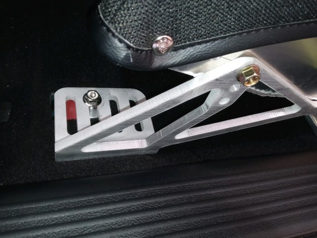

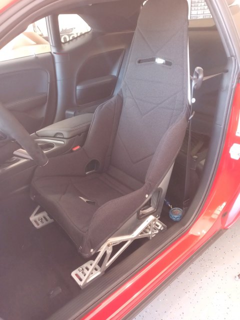

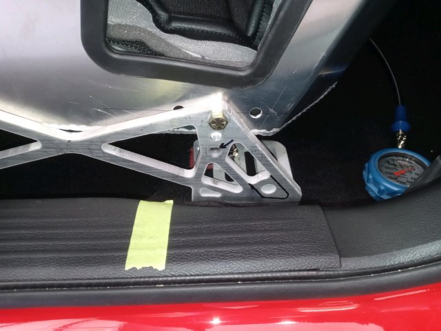

OK, so if you do not want to make your own brackets we have come out with some that are really trick. They are really strong considering how light they are. Made from 3/8" aluminum. I was buying brackets from OMP for about $210 shipped and then extensively modifying them. Now you can buy these and use them as is. They are about 2 pounds each. $450 a set. I beta tested some with a 20" kirkey today. They will also work with a 18.5" and they can be used with a 17" along with spacers same as I was doing before.

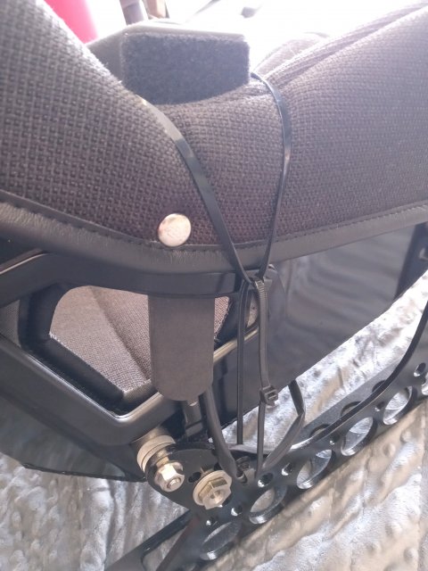

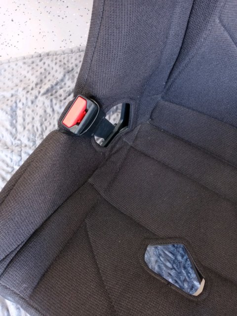

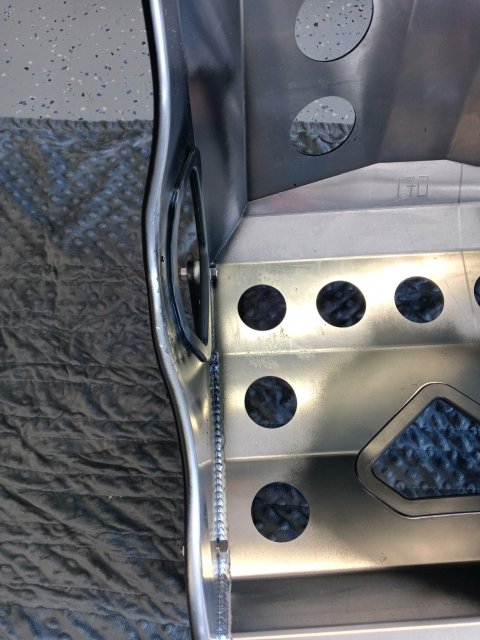

OK Guys, get out the Sledge Hammer. Well really a Single Jack. This has been on my list of honey doos for a while. And my Demon 170 Jailbreak activities have been put on temporary hold.
I did 2 things. I modded the seat to put the seat belt buckle inside and I routed the anchor side inside the cutout. Feels a little better when I am belted in. Likely a little safer if....................
Last pic is the old way........... 0607241449a_HDR.jpg 0607241508.jpg 0607241508a.jpg 0607241539.jpg

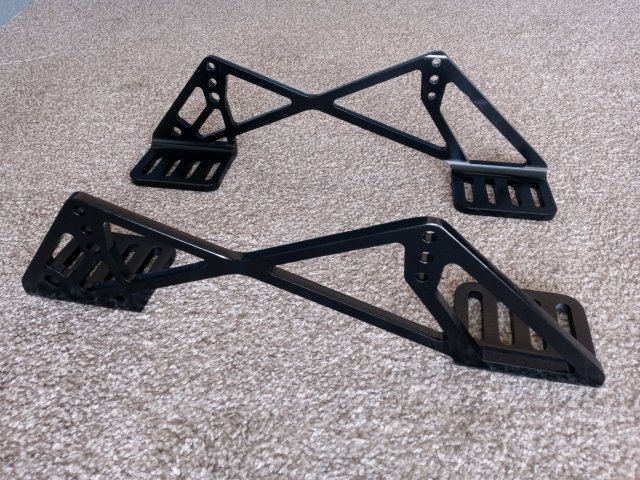

Do you still have these for sale?
No Sir. They are too expensive to sell all set up like this any more. I can hook you up with brackets if you want. 0322241251.jpg
