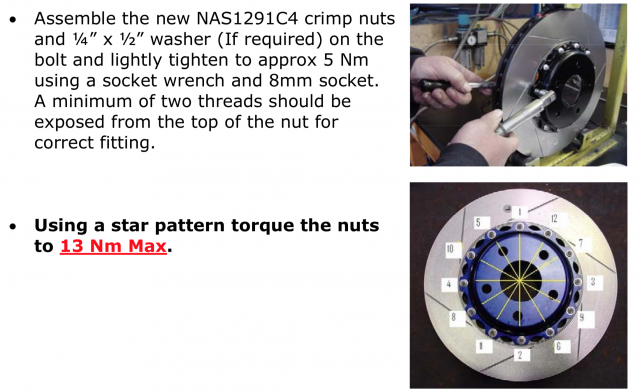

Hey there mihihemi just seeing this thread and I'm rebuilding my front brakes but I'm having a hard time finding just the rotors by themselves. Love your design over the plain old slotted any chance you have a model or part number or brand? Any help would be greatly appreciated. Thanks Dan

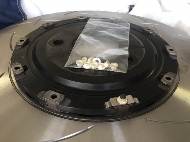

If you go DBA, here’s the nut torque info. It’s easy to do yourself. Just a little tedious and I used a bit of blue Loctite. They also send along new nuts. Nice thing about DBA is they’re non-directional so you can’t mess up which side you install them on.

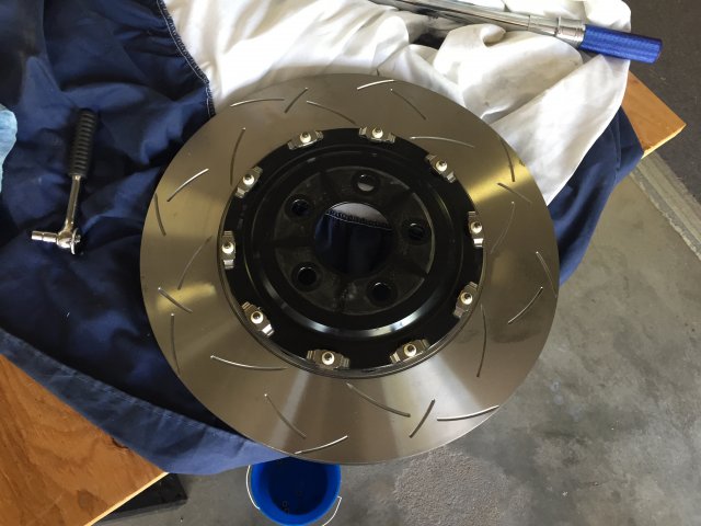

Did you turn the rotors?
Did wife catch you drifting spray paint over the awning and metal frame? ;)

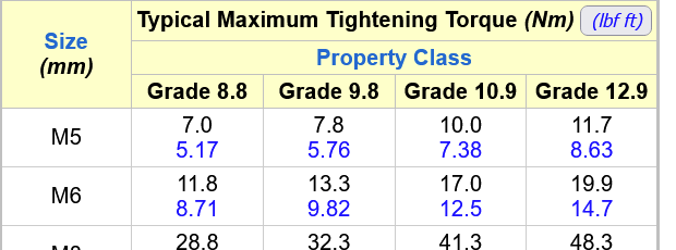

My input on the subject is that there seems to be a torque discrepancy. However, on hardware like this, different hardware can make a notable difference, so keep that in mind.
I've seen values from 65lb-in to 100lb-in and even other values as well.
No and no.
LOL

M6 is the size of course, which grade is critical, and you don't want to use 100% either.
CDT is currently using Grade 10.9 and recommending 120lb-in, but this is not directly applicable to the above information.

The torque info I used was supplied by DBA. 13 Nm = 115 inch/lb or 9.5 ft/lb.
