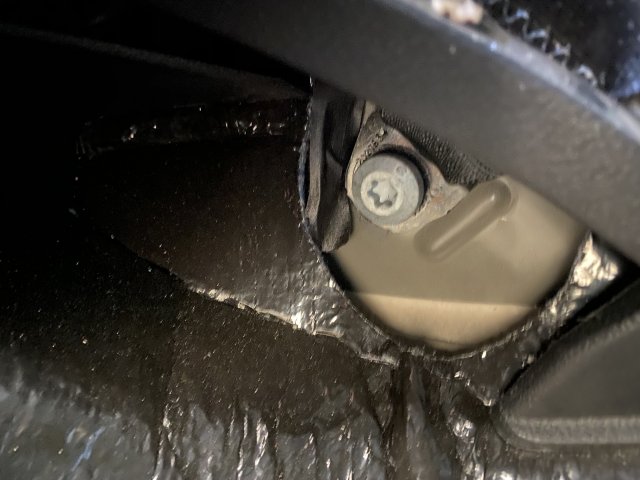

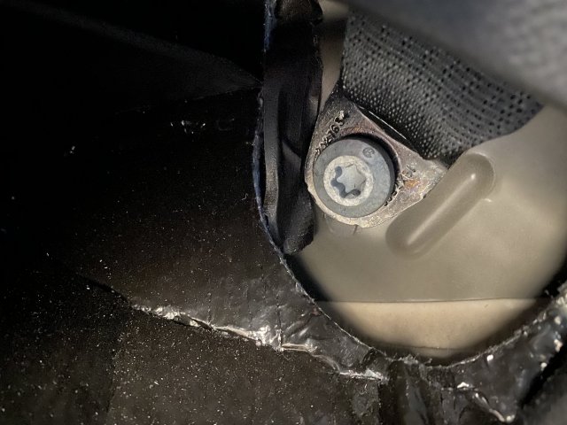

Anyone else having a rough time getting the T50 star bolt out on the bottom of the seat belts.
I’ve tried everything and they won’t come out.
I watched speedy’s video on it as well.
Any tips on how to get them loose?

I was able to break mine loose with just a 3/8 breaker bar. Once I got a few turns on it my 3/8 DeWalt impact spun it out no problem. A few of them were tough.

Just slip a pipe over your ratchet. Floor Jack handle, whatever. They will break free.

Them are tight with lock tight on them I had 2 slightly used T50 lisle bits broke them the rest of the way. Harbor freight junk tools in most cases but with a 3/8 breaker bar got them loose then did my rigid impact to finish it up. Good luck!!

Lol broke 3 T50’s
Where is SPEEDY at?
He makes it look sooooo easy in his you tube video and I’m about to loose my dam mind.
Speedy I’m coming to get you.

I’ve used both. Black ones and the gray/silver ones.
It’s alittle bit of user error too.
I got the passenger side done now I’m on the driver side. Don’t buy the T50 from auto zone. I stripped that one real fast. Gonna hit it again tomorrow morning with the Harbor Freight crap.

That’s what I used was HF and usually there tools are junk but I did all but 2 with HF ! Broke 2 lisle T50’s😡

I used the HF T50 also & it worked, I guess you know that it has to be perfectly straight & engaged all the way in, I used my 1/2" drive torque wrench to break them loose for a few turns, then used my cordless ratchet the rest of the way.
Had a buddy that had a issue with one of his & he messed it up so bad that he ended up having to drill it out, what a PITA that was for him, so don't do that. :LOL:

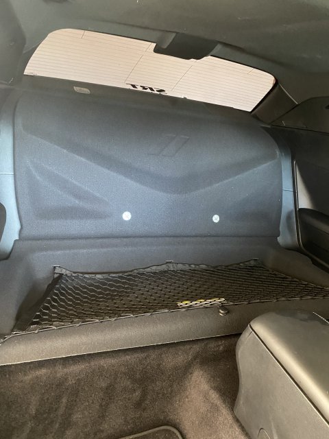

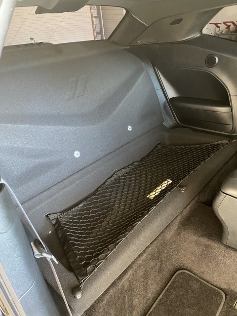

4C5864AC-6582-4E31-98FB-EF842CFF5E9D.jpeg A93C78AF-CCC3-4700-B7AA-928362EE53DF.jpeg
Finally all done! 6”1 and about 220lbs I’d say screw the install lol. Overall looks good. Quality of the kit I give it a 7.5.
Anyone else that does the install them selves be carful of scratching the panels when you pop them off to remove seat belts.
StinkEye gave me a heads up to remove the passenger seat. That made it much easier to install the kit.
