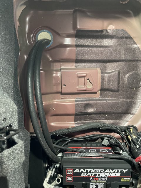

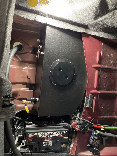

Thread Starter #27
Ended up going over the subframe. Didn’t have to go one exhaust
A43AB590-5743-413F-91CC-6E47D659AE23.jpeg 6D3A8BDA-2C78-48EB-9A04-F3D45E5D6BA5.jpeg
