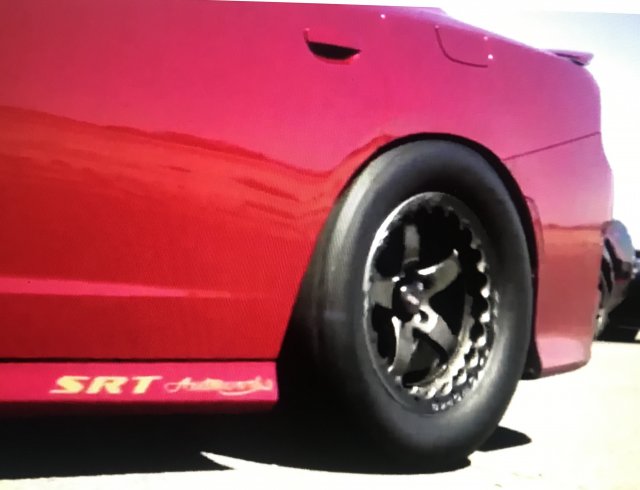

I have 305's but once that's used up I'll get 315s. Our chargers should be able to accommodate a 315 tire without modifications like the Challengers.
I don't believe it's safe to be running spacers on the drag strip but others can chime in if they've done it.
3,581
11,536
Here’s a picture. Not my car. No spacers being used. 7C575B2C-9517-42DE-88C2-623C4C8D55BF.jpeg

Here’s a picture. Not my car. No spacers being used. View attachment 9953
Appreciate it, and I understand...the Challengers have more room than Chargers.
Anyone have a Charger that already has 315s on and drag race?

You got that backwards.
Widebody aside...charger has more room than challenger.
