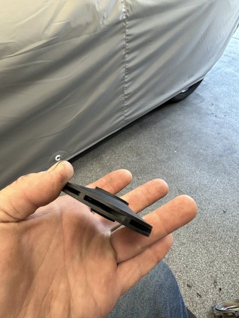

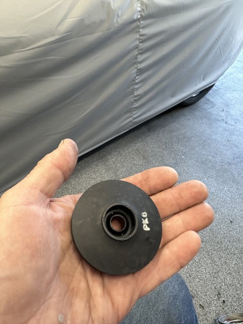

Sitting around board today looking at the stock intercooler pump on the bench and thought why not pull it apart and I was shocked to see how big the propellor was this thing must pump a lot of water to the Super Charger

I think you were bored, not unless you were sitting on a board contemplating the efficiency of the pump :LOL: In all reality depending on the pump speed and the specific gravity of the coolant solution. It looks like that impeller would pump less than 4 GPM @ 1100 rpm, but who knows if that DC pump motor is constant speed or variable. my guess it is constant speed to keep the cost down. If you trimmed the diameter down it would have more effect on head and power consumption than changing the actual flow capacity of the pump,
