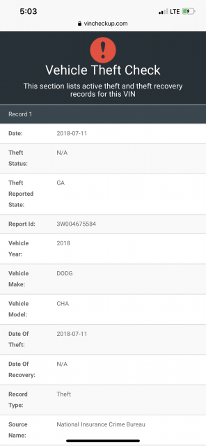

Everything looks to be correct on this car except the VIN. Even matches the window sticker
Makes me think car stolen and VIN tag changed. Is their a registry of whom owns which number? I had a 2001 Mustang Bullitt which are numbered and on the Bullitt site they had every number and you could put it which one was yours

Demon 2074 was reported stolen on 7-11-2018 out of Georgia
You a better detective then I. I have been searching the same thing with no luck so far
