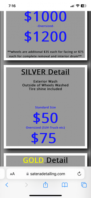

because I was curious what silver was. Dang they don’t even clean the inside of the wheel. Shoot.
6,567
42,127
Well, there ya go.....We Now know they Do a Half ass job!
