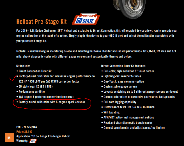

I was saying, just do your research and really understand what you're getting. Most people won't, and Dodge is counting on that I'm sure. Notice they call it a "touch screen device" which misleads you in to thinking it's the build in touch screen and will work like the Demon when in reality it's a hand held tuner you mount to the windshield, IE Diablo T2. So what that's gonna mean is you have to load tunes and data log and a lot of you guys seem to want to avoid that.
Also the part circled in red makes ZERO sense especially for the "pre stage" kit. It says you pick up a measly 5HP but then says it's a factory tuned cal with 5 deg spark advance?? What's that mean? 5 deg on top of a normal cal would net over 50RWHP and it's not possible to do that on pump gas anyway. When you finally step up to a pulley you get 40HP for over $2,000 BEFORE install charges to keep that precious warranty. 40HP wouldn't be worth it for me. If I'm going in there I want 100+.
@DGatzby 80% of the performance improvements in custom tunes are in the transmission and throttle response. I don't see them mention transmission tune updates, did I miss it?

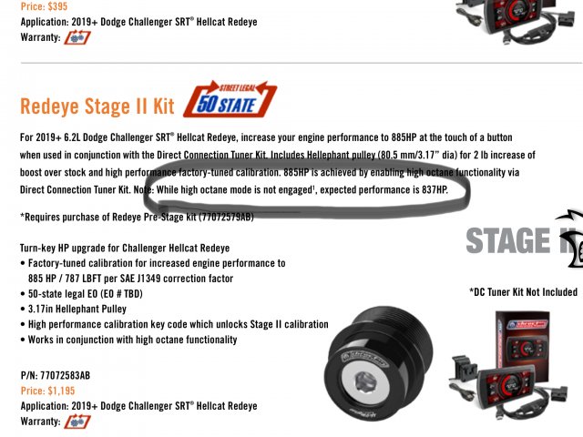

The biggest negative takeaway for me is that both Stage 1 & 2 upgrade packages require 100-octane unleaded - right?
For Redeye YES to get the advertised power, but it will run on pump gas at a lower power output. Another oddity is that Stage I for RE says 840 but required HO fuel. Then Stage II adds a pulley for 2 more pounds of boost for 885 on HO but says it'll run at 837 when not in HO mode but on 2 more psi of boost so WTH? So which is it LOL?
Honestly the RE Stage II looks like the most bang for the buck for this stuff but if going that route I'd still get a known good tuner setup for E85 and call it done and make 50-70 more HP on top of 885 and do flex fuel to boot.
Doesn't appear there's a Stage II for standard Hellcat that I saw so 40HP not really worth it IMO.
Can you imagine all the folks that don't know about this forum just running to the dealership blindly throwing the money LOL.

Hey @Speedy!, I agree, I don’t see anything about the tranny. That is why I condition any idea it is my solution on hearing what the first few say about that. I listen close to your stuff, and have given you lots of (y), keep it up. I am not beyond just working with an interested tuner for road courses soon.

@DGatzby you don't get 840 on 93 sir. 100 octane required assuming you're talking about these Stage kits.
Don’t we get the 838 stage two with the increased boost?
"Maybe"? but I'd be REAL leery of running that on 93 personally especially for what you do with the car. The pulley brings you to 16.5 PSI of boost and that's a lot for pump gas in one of these. Mine makes 17 on the 2.72 and remember how that was never recommended for pump gas. I don't hammer it on 93.
837, 838, 840 WTF among friends, close. Let’s see if this is not some conservative number under the proverbial 840 hp high octane Demon Tune. Interesting it takes a Demon 100 octane to do this, but a potential tune for a RE is the same on “pump” gas.
