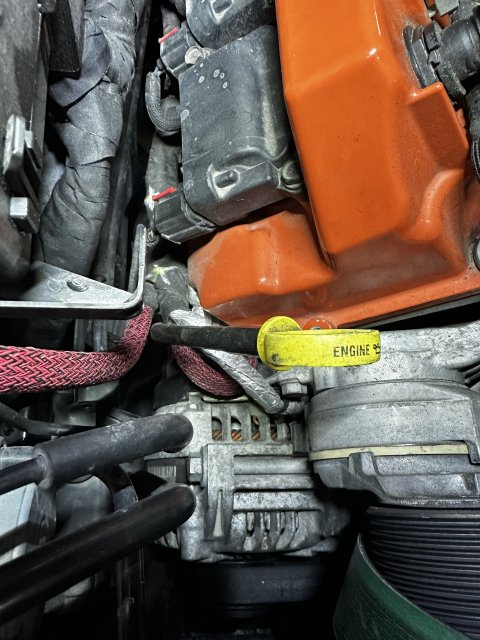

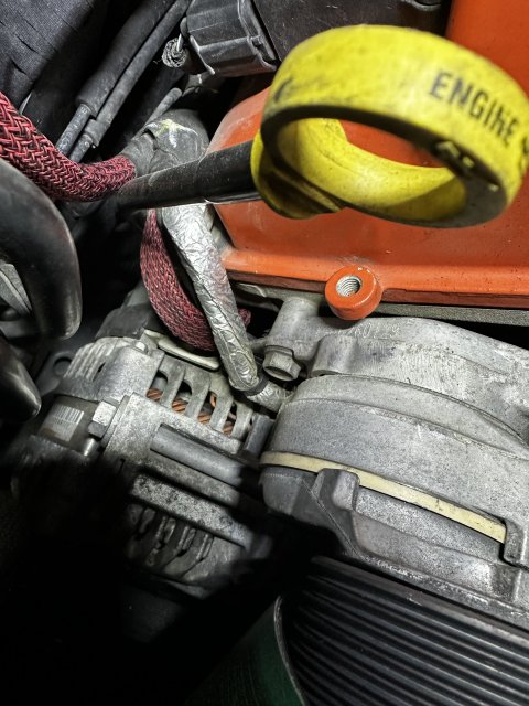

Can’t move the alternator/coil wire harness because on the challenger that sensor that’s behind the alternator is in that same loom and splits right at the end of the valve cover so no play. Had alternator off before, not doing that again lol

Tight. I did not use anti seize. I reused the factory bolts instead of those stage 5s because you will have a hell of a time getting those clips on with the engine in. I also bought stock gaskets because headers normally come with junk but the kooks do have good gaskets. I bought some longer 1/4 gearwrenches and other sockets I thought might help. The hardest part is breaking them loose in some tight spaces. I just tighten them the best I could. I have have not had any leaks. 2 sets of hands goes a long way if someone on top and cant see the bolt or being on the bottom to help get sockets or wrenches on
Thanks for all the tips! I got factory gaskets and new factory hardware, just in case there’s issues with the old bolts. I think they’re either supposed to be 20 or 40ft lbs, but I’ll just do as tight as I can (without pulling threads out of the heads)
