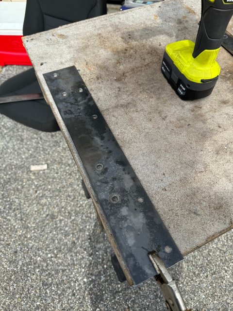

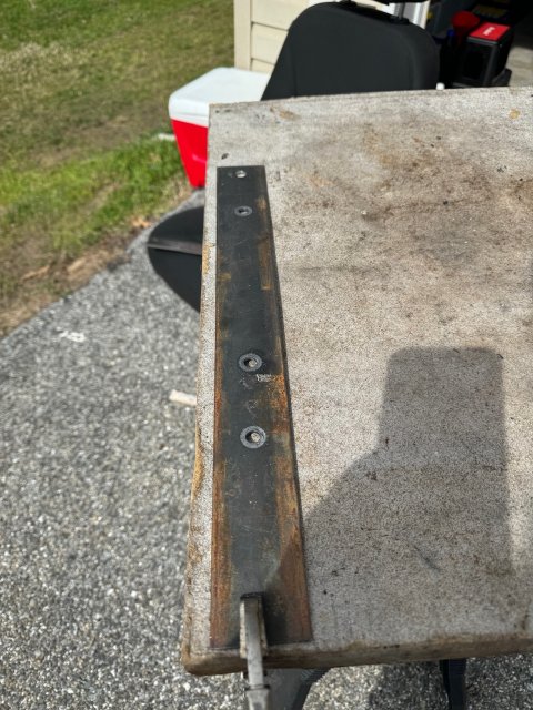

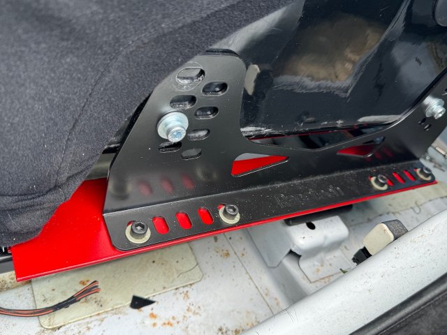

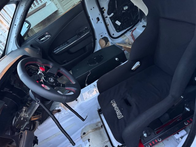

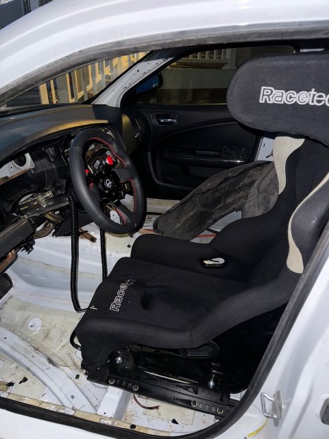

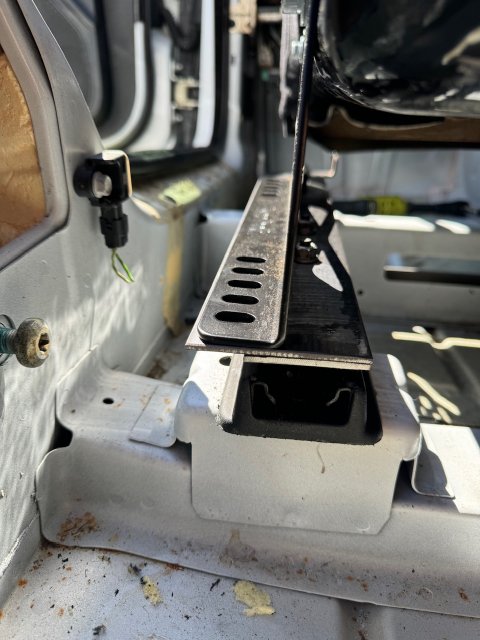

Started with 2”x18”x1/8” steel drilled to fit on the stock sliders.
as you can see the brackets overhang a lot, on the shelf added a 3”x18”x1/8” overhang for them to bolt to.
doing a test for height, had to lower the seat as I dont know where the bars will land yet, also helps me figure out placement of the th400 shifter finally
have to run the vacuum again. Todo: remove seat final time. Do final welds of the bars together. Paint them and final assembly.

All hardware is 12.9, anything else is asking for it!
#racetech seats with custom brackets for the win!

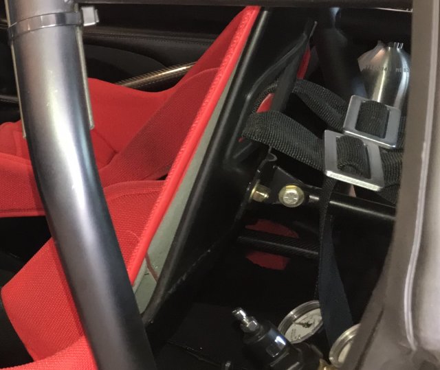

It’s possible that a strict NHRA tech might have an issue with using a slider on a race seat. One of the things I have actually had them check is the required brace connecting the back of the seat to the roll cage. That will make the seat fixed. I can only find one picture where you can see it with my Kirkey. IMG_4951.jpeg

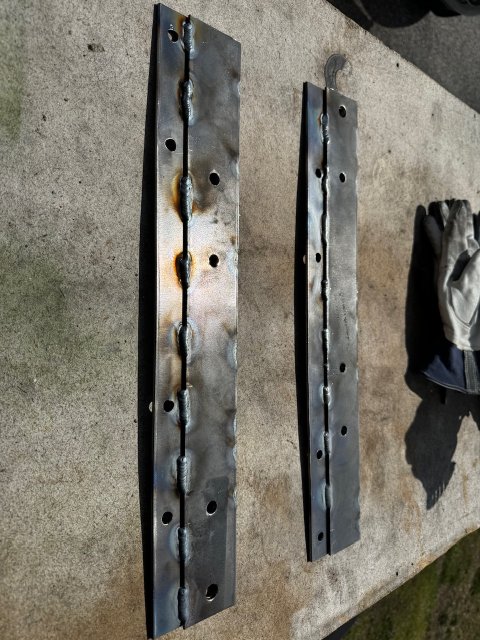

in other news, i've been going every day teaching myself tig again and practicing. seems like every cage builder in Maryland is booked or doesn't want to work with me. I have four 20' sticks of 1-5/8” OD x.083 cm sitting in my back yard.

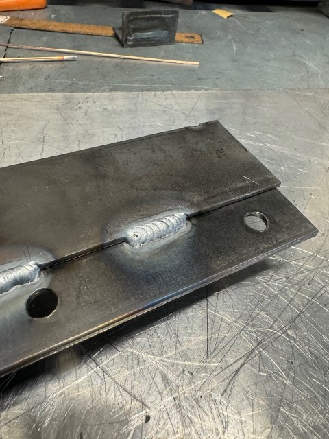

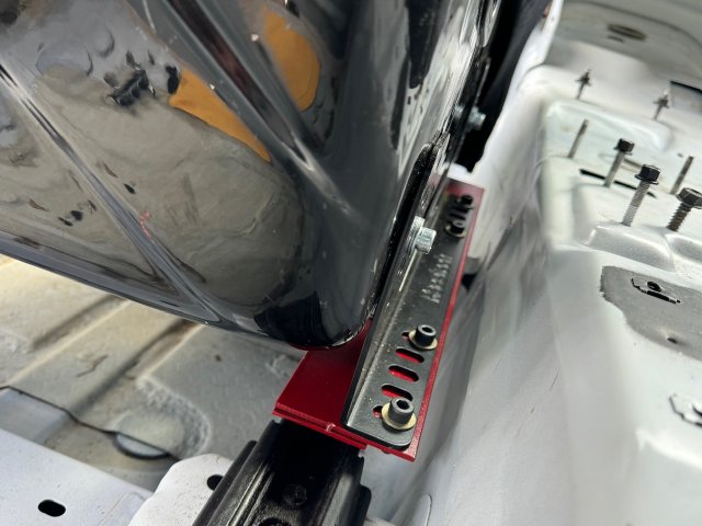

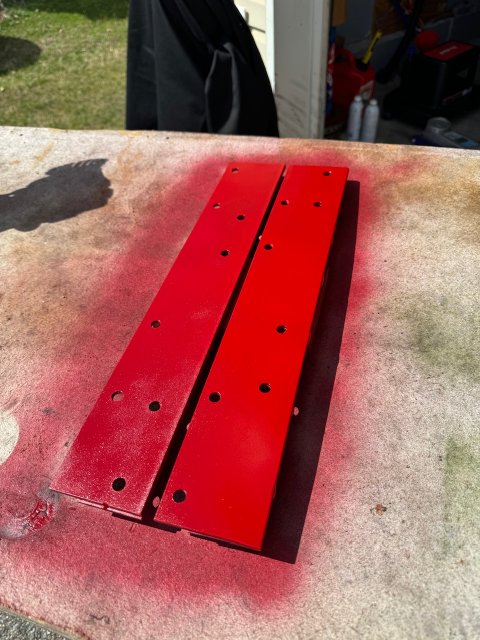

Finished products! Didnt weld the front a d back edges as there are also welds on the backside and the lap joints.

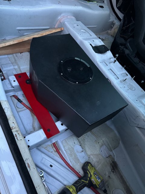

I may have had too much fun with the red paint this weekend.

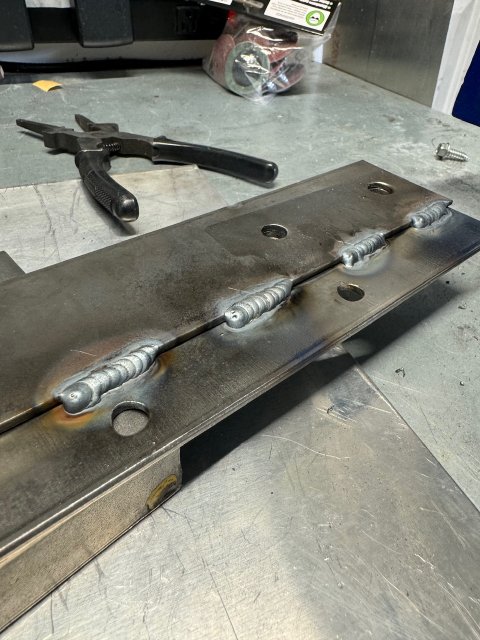

Had a chance to get this all welded up and in the car. It ain’t easy. Had my weld settings all wrong and was struggling till I looked at the damn machine after getting cold welds. Had to redo them all… 🥲

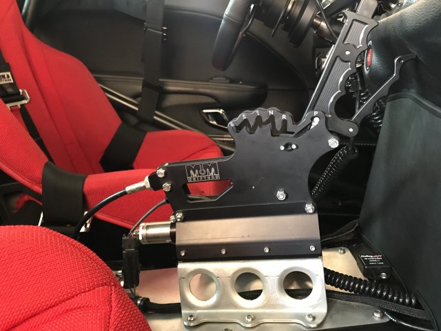

Good job on learning to do stuff yourself 👍🏼. I welded full time for eight years to pay the bills when I was first on my own. We make these… IMG_4961.jpeg

I can't remember if you are Co2 or air assisted in shifting? Do you not touch the shifter at all during a pass. Those mounts are a beauty. I need to learn this skill and the more practice I put in the better I'll get.
