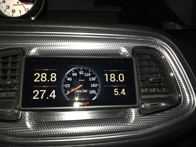

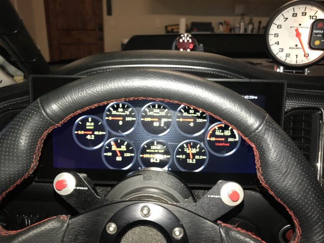

Is that the Holley screen? I was comparing the Mopar controller and the Holley Terminator X Max for the Gen 3 Hemis. I was about to buy the mopar controller but someone said reach out to people that are running the 6.2 with the Holley.
You're a baller so you probably have the Dominator.

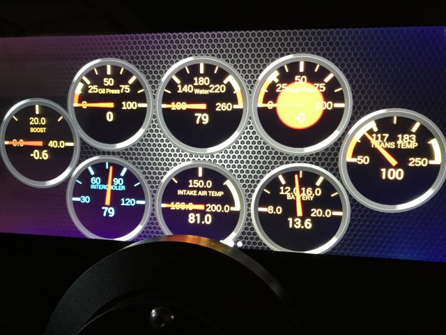

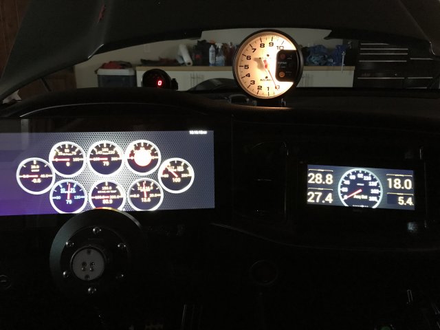

Lol yes I have the Dominator. But… the blue car is running the Terminator. While the Dominator has a bunch more inputs for sensors and some other really high level stuff (it better for the cost) the Terminator will run a electronic bypass and the Dominator won’t. That blue thing has kicked my ass so far. Ditching the factory ecu and going with a stand alone like Holley EFI is soooo much easier to tune. No more trying to figure out wtf is it doing now. As far as the displays go…. That’s the most bitchin thing in the car. I started out with the 6” display. Once I saw the 12” working in the blue car, I had to have that! So now I got both. You can configure them to display any combinations of gauges or info you want. You will entertain yourself for hours. 019C6DE6-CC72-4AF4-9DD1-1B3AE26E5BCB.jpeg 2629E5B9-6D11-45F5-83A5-B6C7DFF8E352.jpeg 88FEADA8-6E2A-4FA9-8EA3-C92C982F5D42.jpeg

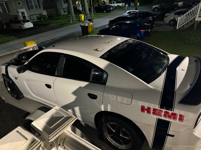

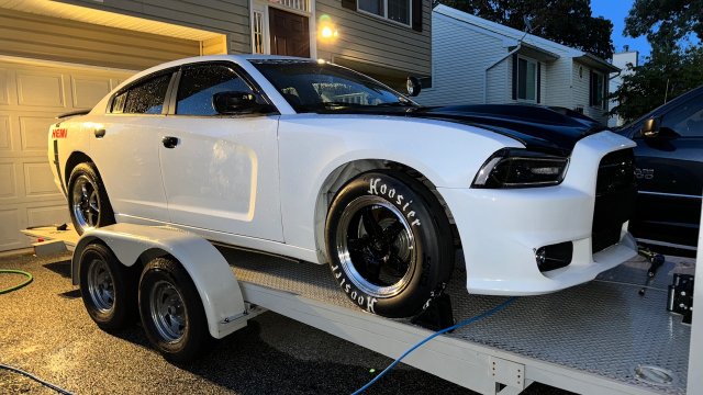

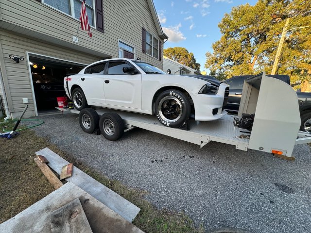

Okay first months mods. 15” rear conversion and aad suspension. DSS has given me a lead time on their 9” kit so thats in the pipeline. The paint cleaned up okay. The interior is about to be sent to the landfill.
cannot wait to goo gone/heat gun off that vinyl.
