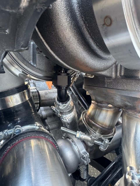

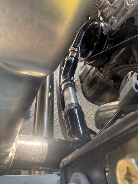

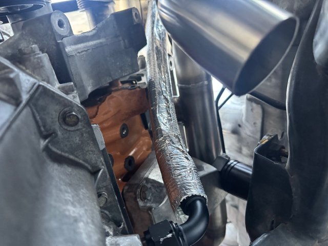

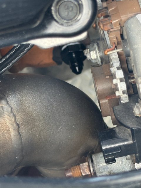

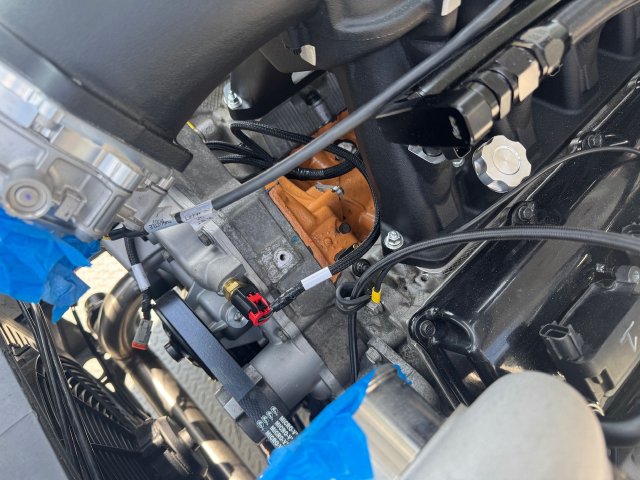

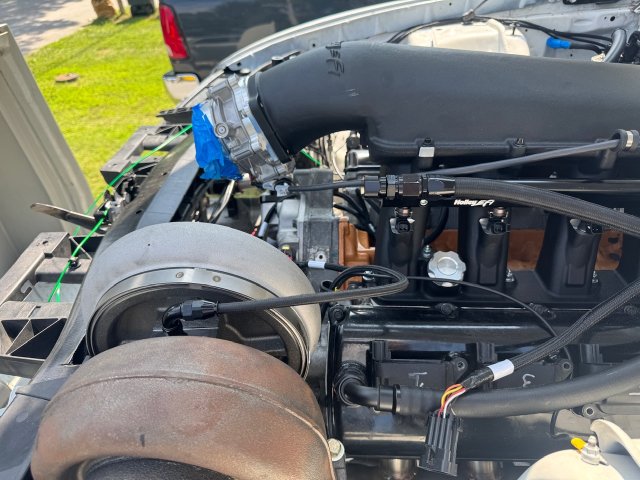

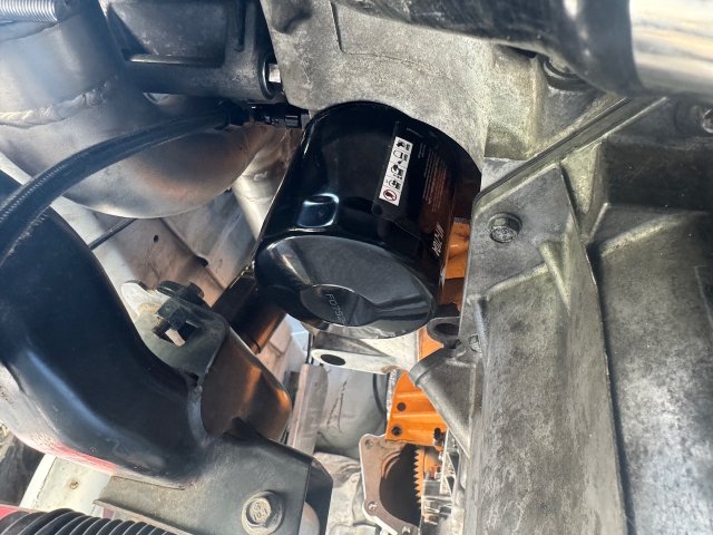

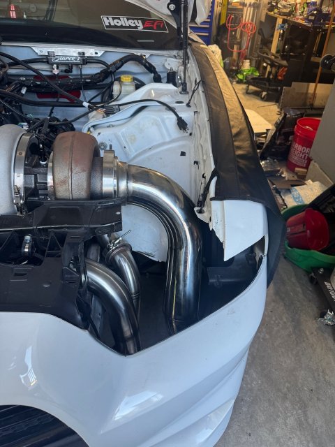

Good progress starting to look like an engine bay coolant system and oil systems are sealed. Waiting on new map sensor and a dome sensor. Then I can plumb the turbos, write a config to Holley and get ‘r done.

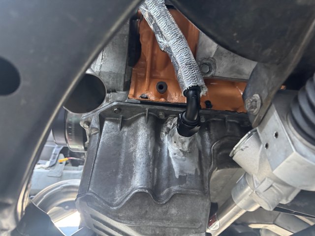

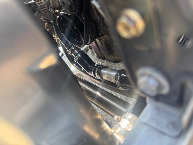

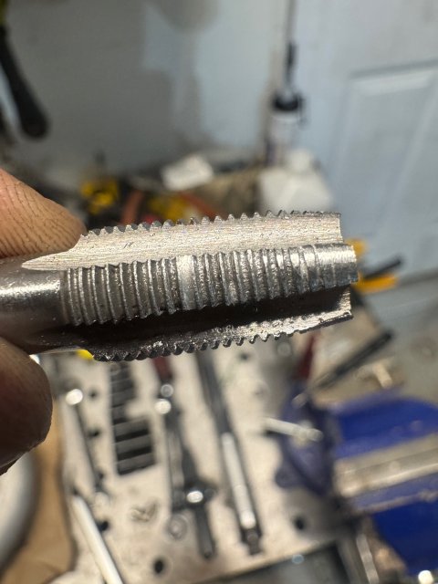

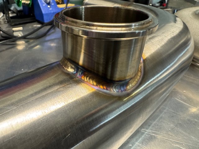

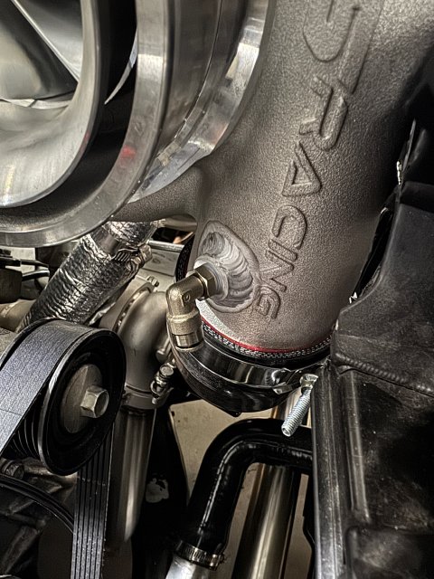

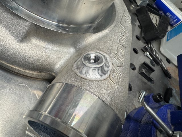

The things they never mention in the instruction manuals. Man building a turbo car does have a learning curve 🤣😭

Nice looking welds. I remember your learning thread.
Oh hell no, took these to a real welder. I bungled the npt threads cause god hates me, npt tap galled up and well infinite spins

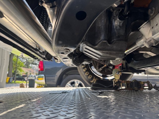

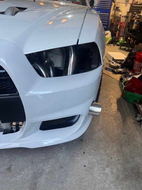

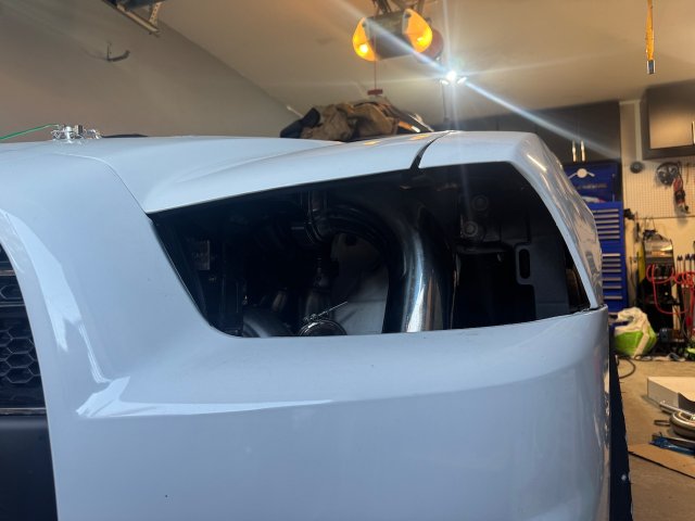

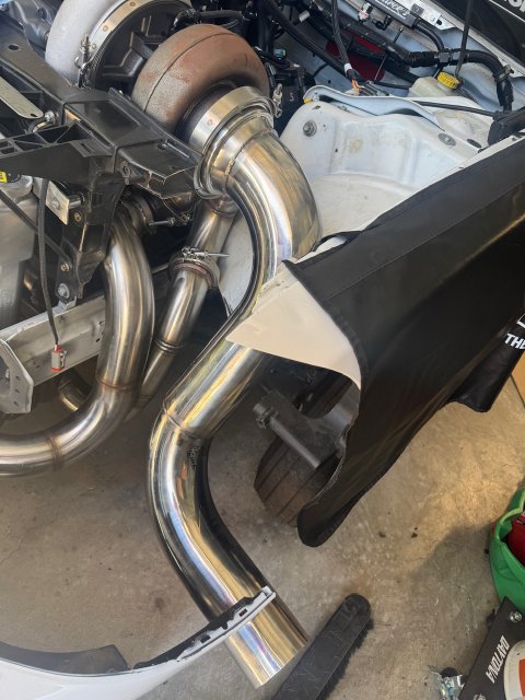

Shin destroyer 9000
its going to get a vband so I dont have to take the exhaust off to take the bumper off.

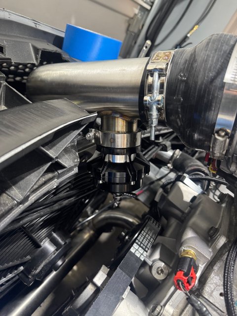

Wastegates are being an absolute pita to route lines to (artifact of turbo kit), also found out the oil pan bung for the turbo drain is leaking so that needs to come off (Pissed off at Mike for that one as he gave me his old pan), still a ton of wiring left and I haven't even started the car yet. Still have to test fuel system. I've been at this shit for every evening for a month and I'm just tired.
I'm still scared as shit to start it as this is my first ever engine not to mention the shop is slammed so I can't even get a lift right now. Oh I also need to remove the abs module, too much shit is in the way. It's just a lot, overwhelmed. Hindsight is 20/20, stay supercharged my friends. Turbos or DIY turbos ain't it on these platforms.
