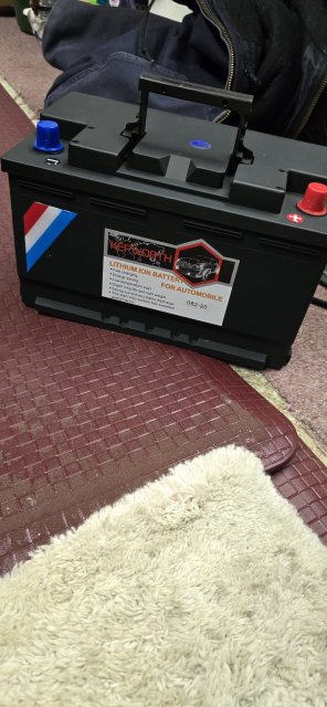

I bought this one on amazon and had to send it back. My battery light would not shut off. It was showing 14.2 volts constantly while my 21 RE only showed 13.8 to 14.0 with my factory battery. I also got codes for ABS system and stability control suddenly. Coincidence? I don't know but this car has never thrown a code in its 7000 miles. I switched back to the factory battery and the battery light went out. I checked the voltage on the Lithium battery off the car and it was 14.2 volts. 1000008662.jpg

I bought this one on amazon and had to send it back. My battery light would not shut off. It was showing 14.2 volts constantly while my 21 RE only showed 13.8 to 14.0 with my factory battery. I also got codes for ABS system and stability control suddenly. Coincidence? I don't know but this car has never thrown a code in its 7000 miles. I switched back to the factory battery and the battery light went out. I checked the voltage on the Lithium battery off the car and it was 14.2 volts. View attachment 163952
And I still have not gotten rid of the codes. The scanner says left rear tone wheel - general signal failure. I checked the wires to the sensor on that wheel and can find no damage or bad connections. The car has never been driven in the rain. Can an ABS ring suddenly go bad like that?

Battery made it today. I ordered it April 24th and it said May 14-June 7th for delivery so pretty happy it was early. It was advertised at 11.9 lbs but weighed 14.8 lbs. I made a bracket out of flat aluminum being it was shorter so I could bolt it down like the factory battery. Starts real fast like my arc angel did. Still a savings of 30lbs

Thats the one that caused my battery light to stay on. And then I got codes about ABS and stability control, with a scanner saying I have a bad left rear tone ring. It ran at 14.2 volts. I put my factory battery back and the battery light went out. It now runs at 13.8 to 14 volts. The codes have not cleared however. It's a ton of work to pull the rear suspension apart and replace the tone ring. I hate to go thru that if it could be an electrical problem caused by overvoltage.
And to make it worse...I pulled and replaced the rear axles with Gforce later on that day after the dash warning lights appeared. I had to remove the rings and put them on the new axles. I did not get the opportunity to get the codes read until a few days later! Like I really want to take it apart again after buying a new ring...if they are even available.
I will also check the fuse on the battery in case the higher voltage messed that up.

Its strange that we are all getting these different values. But I have no more problems with the battery light. I opted to replace the left rear ABS sensor before going to all the work of doing a tone ring. Thank goodness! The new $39 sensor took care of the problem. No more codes. Now I am wondering if that sensor went due to the high voltage issue with the battery? Regardless....the battery has been returned and everything is perfect once again with the car.
