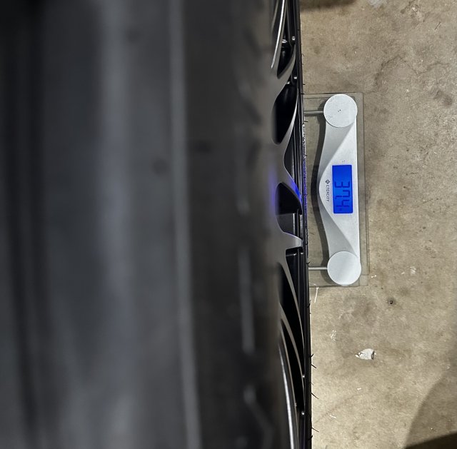

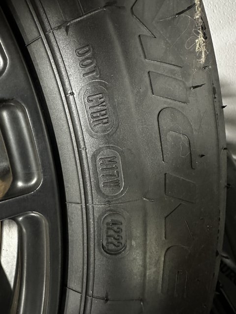

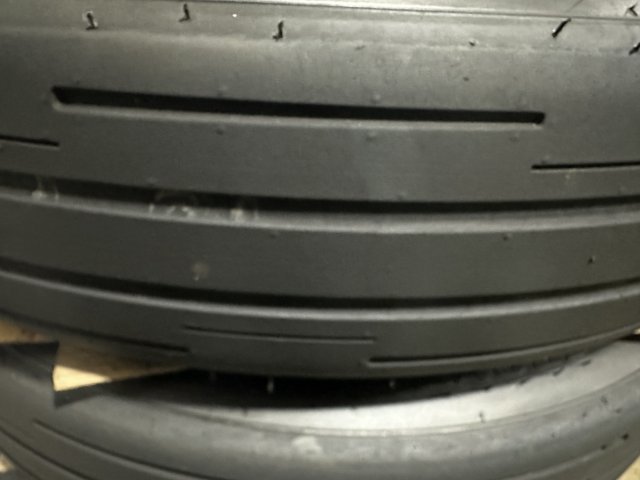

They’re a little heavier than I remember with wheel aired up to 50 psi and custom hub bore rings in them

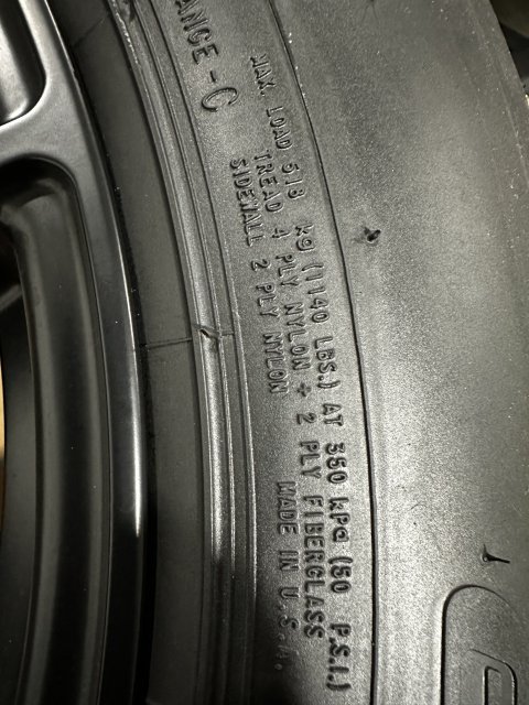

37.4 lbs with wheel, max load rating is 1140 lbs at 50 psi. These were made in 2022

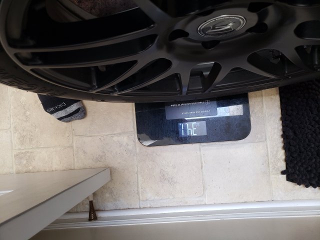

We have a new scale so here is my f14 with m&h 34.1 lbs

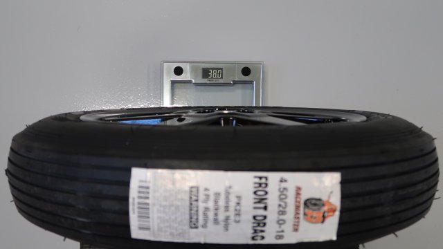

The lightest:
Hoosier Drag Race Front.
28x4.5-18; PN 18112.
Those are the ones I've been looking at. They say 12lbs per tire. My current M&H front runners are 22 per tire if memory serves, so 10 lbs of rotating weight per side would be quite a bit off the front.

Does m&h give a load rating? They’re bias ply, right?

yes they are and they don't have show one
