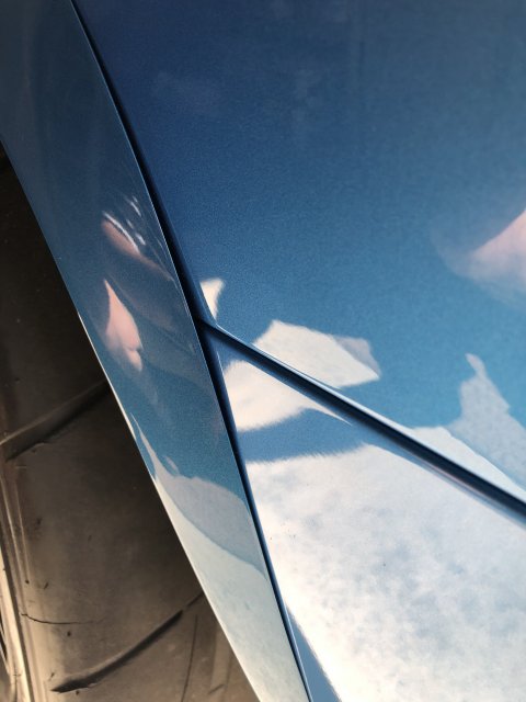

Pass side looks great comparatively speaking, other than color match, but drivers side is quite far from outstanding.
4,847
25,745
Thread Starter #262
Yes, of course. Pass side fit is fine. Latest version btw, with magnets.
The step I missed first attempt was tapping the flair during the install. Made a big difference for me.
2,618
7,203
Yes sir, tried that. If I close up the top, the side gets wider, and vice versa.

My rear flare fitment sucks.
2,618
7,203
I believe I can tighten up the fit towards the rear of the wheel well by double face taping the wheel well liner to the frame. Doing that seems to pull the bumper cover inboard and tightening up the fit between the flare, bumper cover and quarter panel. Im going to grab some tape tomorrow and update you guys. When the plastic rivet tool arrives I’ll use it to mount the fronts and re-secure the rears. In the meantime what film are you guys using to prevent rocks from hammering the finish on these? Thanks.
2,618
7,203

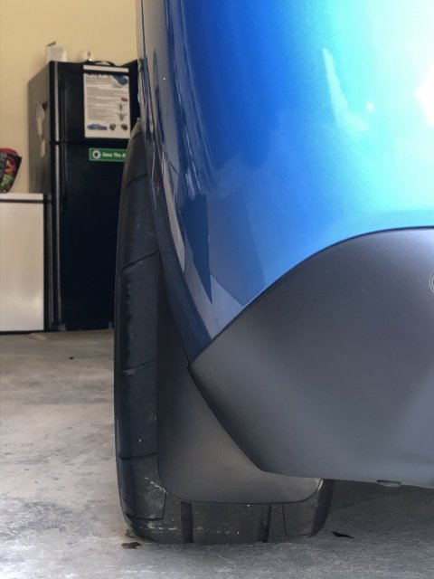

So after messing a bit with it using some Scotch brand double sided tape I was able to tighten the fit of the top of the flare. Hopefully that stays put. The rear section is going to require moving the rear bumper cover on the drivers side in more towards the middle of the car. Seems if I can deflect that area right behind the rear wheel inwards about 1/2-1 inch that will alleviate the gap at roughly 3pm. Just how Im going to manage that is yet to be determined. The wheel well liner isn’t close enough to the sheet metal behind the liner to just pop in a plastic rivet, so Ive got to figure something else, or live with it.
Although the flare is not mounted here the black piece of trim on the bottom is what I’m referring to. Moving that inboard takes the bumper cover with it and closes the last gap. Mopar stone guards have been removed btw.

I would be thrilled if mine looked that good!
2,618
7,203
Sorry to hear that. I may just quit screwing with it, we will see. I’m waiting for the rivet tool to arrive so I can secure the fronts. I don’t want to use the Phillips supplied pieces as many guys suggested.
