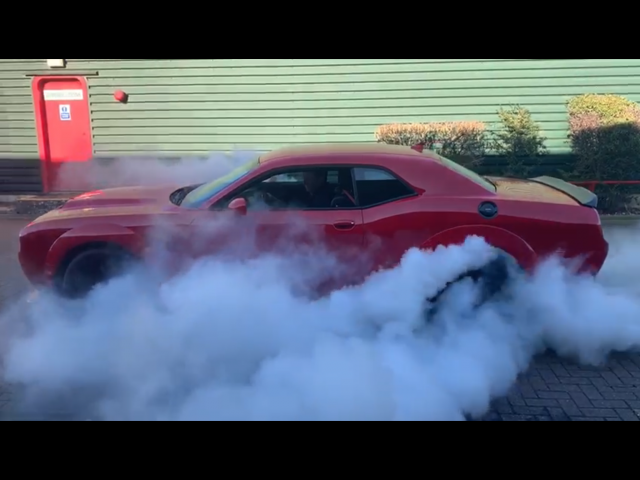

Hell yeah! I waited over forty years for a line lock and now I wouldn’t be without one😎
