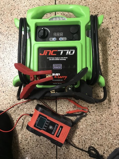

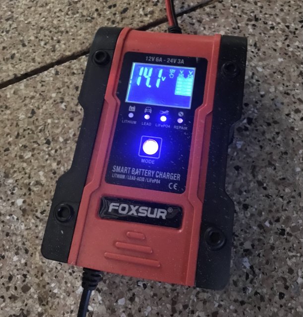

Well crap. Weather's been crap and I've not driven GoManGo in about 6 weeks. Went out to the garage to check it and the Arc Angel battery seems to have lost enough charge that it won't power the car. DMM says 11.38V. I don't think you can jump a L-ION battery.
What do I need, a trickle charger for L-ION to get it back up to snuff?
CEF137A1-E241-4269-9F75-455A74504043.jpeg E460587C-E64A-41AD-A0E8-FDF1246DCCF0.jpeg
Something like this?? https://amzn.to/3JlRXL5

I ended up getting the NOCO 5 charger. Amazingly it said if I ordered today I'd get it today and sure enough I did. It's charging the battery now although I think it's gonna take about 5 hours to get it full. Pretty happy with the little unit. Super compact and nice connectors, but I do wish it had the readout on it for voltage, temp, etc. 13,000 amazon reviews said it was great though.
Got this one: https://amzn.to/3WFIuBu
Yes you do. This is the one I’ve had for years and it works great. image.jpg
