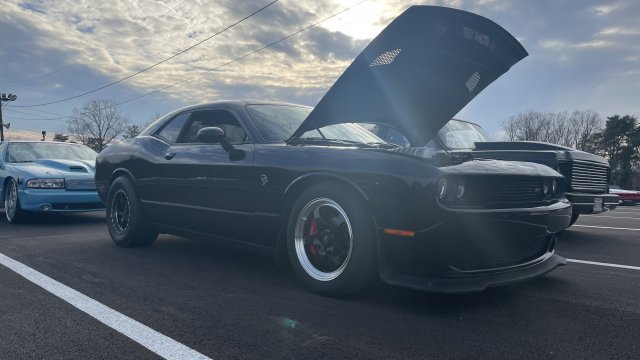

Big bishes on, she #thicc, happy to report longer studs and spacer doing their thing.
F4894513-9DE9-42E9-B91D-90FFDD4A35E3.jpeg 7A0E1C3F-D04E-401F-9683-FFCA636FDF8D.jpeg
Yepper,, all my flea on says had to have the longer studs.Youz know kinda like a snow stud not a run flat like in Tennessee. Soz, I brought em all down here with me. Kina like a condon mation.

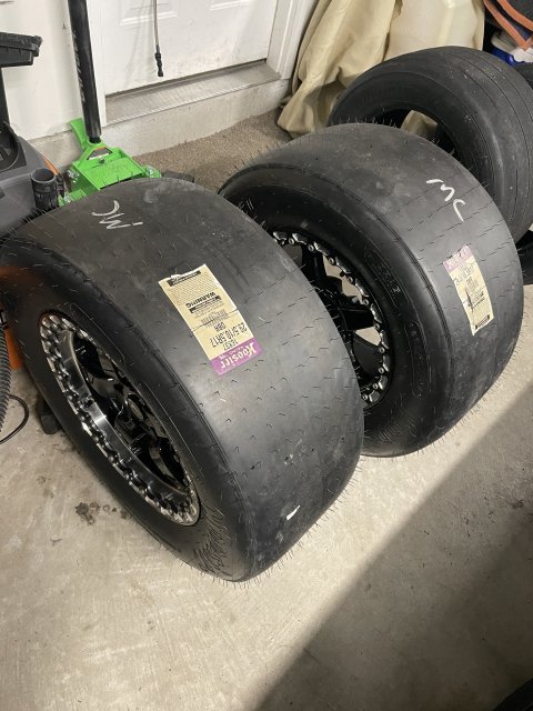

The car is loving these injectors, I'm loving feeling competent enough to go in there and tweak. My review of the DBR's is still pending. Learned they behave more like a slick than a radial even though they have a radial compound. Also don't go below 18PSI otherwise they really behave like a slick. Was getting a little "jut" in the ass on the 1/8th cause they were spinning so fast they were folding over. Puckering moment for sure.

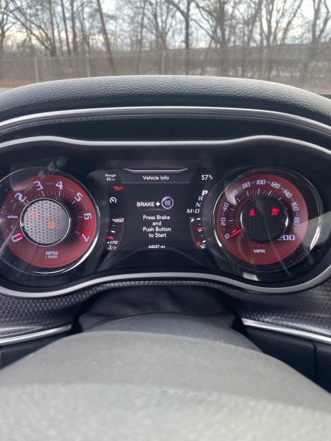

I am glad now I just need that killer chiller to ship. 120* iats had me a little worrie
The taller tire for sure is doing that. One thing I may tweak is raising shift points. That MPH is going to get nuttier. Also she was a fat pig.

You're worried about 120 IAT?? I've seen 165!!!

Yea but 120 usually turns to 140 and thats where it will start to pull timing. Trying to avoid that.

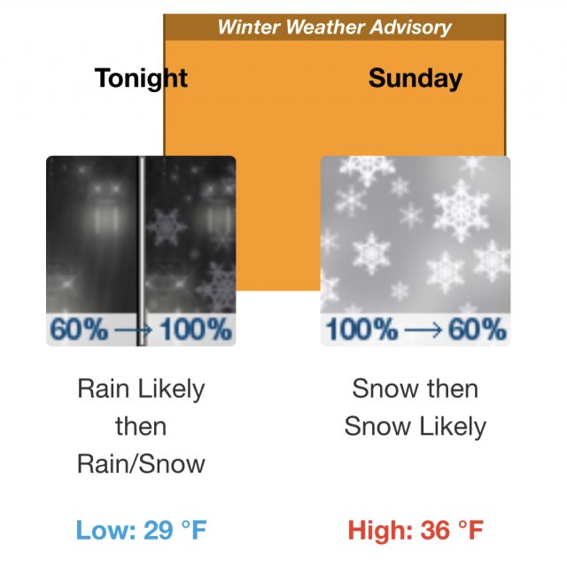

I'm more shocked you don't have snow on the ground in Maryland. We have lots and 20 degree highs right now
You keep that bad juju over there. Tonights forecast.🙃

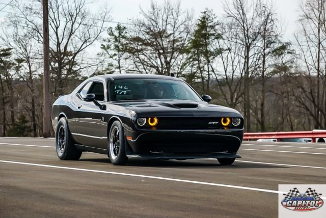

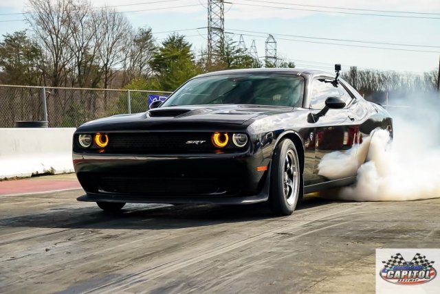

Track photographer went in!

Above 140 iats and it pulled timing. I want them a lot colder. Also just not fun when the car is that hot.
Only 140°?
