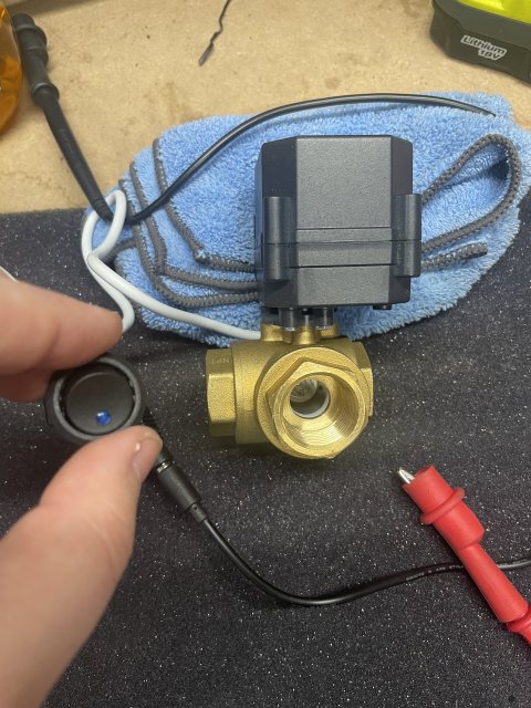

Dormant state, going to stock HE. (Open circut)
Active state, going to KC only.

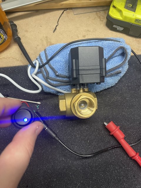

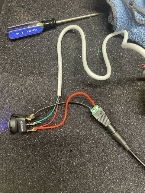

SPST switch that came in the kit. Plan on wiring it this way. Need to find a 12v power source/ ground in the console for use.
I do a lot of tinkering with 12v car electronics. Cannot recommend this little doodad enough.

For 12v I tapped into the cigarette socket on the passenger side of the console, it's key on power.

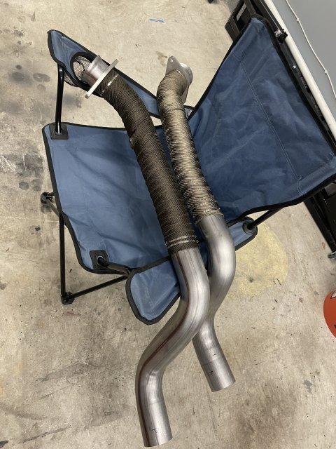

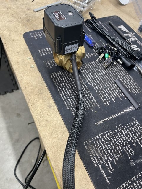

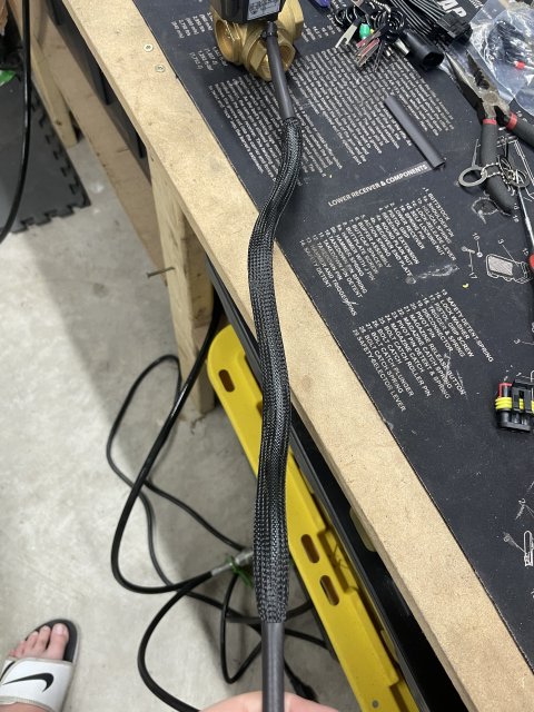

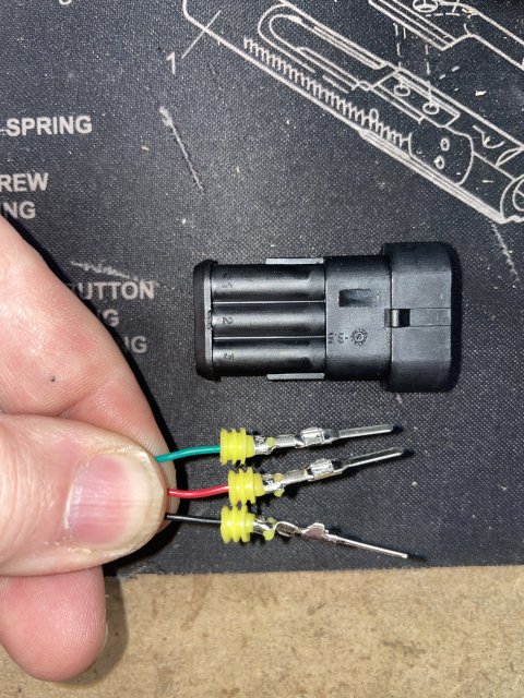

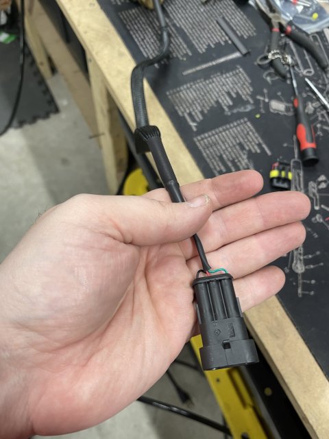

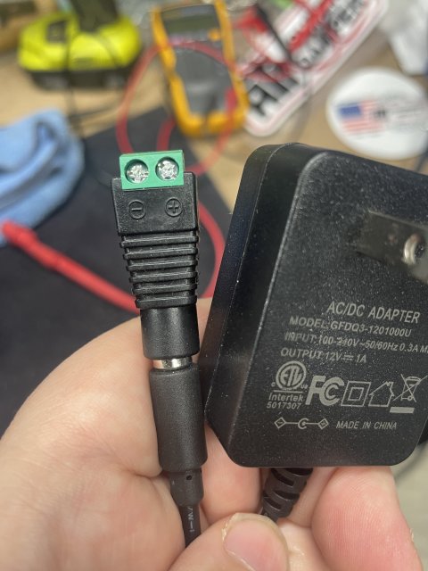

Got the harness ready for the HE bypass. Wiring up the switches today as well. Also got the pipes wrapped to keep some heat off.

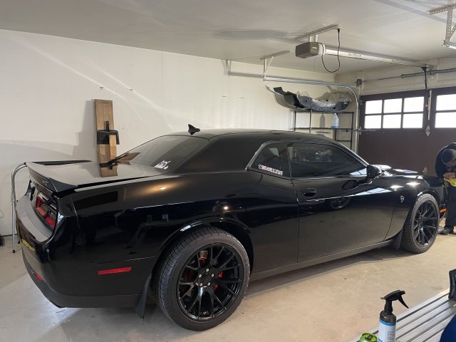

Car is getting ceramic coated today and will be back tomorrow.
