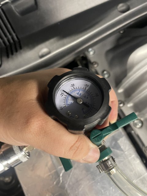

So went to the shop. We pulled out the material that was in there. Was less than what we charged it with, we can only speculate the txv valve is leaking or the unit itself. Inspected all fittings, noticed small yellow die on the threads when we put it under UV, nothing major though as when we put the machine back on, diagnosis ran and held vacuum for ten minutes straight. Put it back in, charges to Joe’s specs and ran the car as per the diagnostics, AC in car blows ice cold. Enough to make your nipples cut glass. Turn on KC bypass and then turn on max AC and then hit the drag valve. Nothing… line after the TXV is still warm.
Got on the phone with Joe, very supportive. New unit will be out tomorrow or Sat., will box up old one and send back for autopsy. Lessons learned, will not keep the chiller in its current location, cannot inspect it easily, also want to move the drag valve.

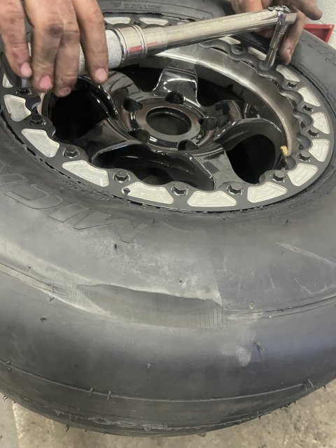

15s are on, however as usual car bites me in the ass. Did a test drive. Didnt hear a single grinding noise. Middle of the trip home, grinding like hell. Brand new fucking D5s ruined.
I hate this car cause theres more carnage.
In addition fucking tires from vendor have a huge gash. I didnt notice on delivery.

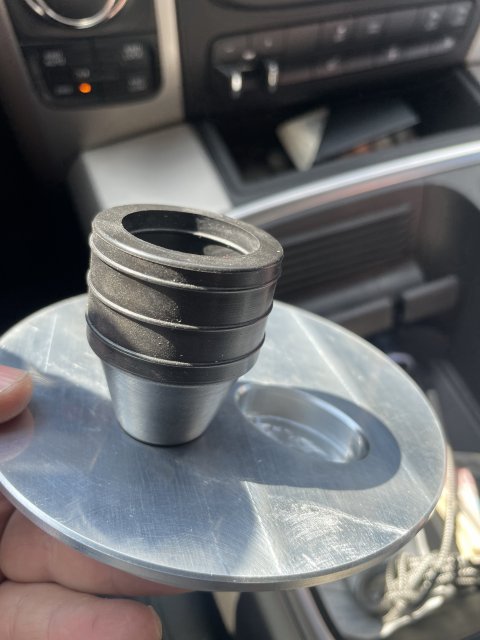

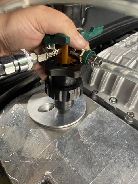

In some positive news, Joe is sending me a whole new unit. This means the car will be back, soonish… for when thats ready I have been doing some RnD with BMR, purchased a new lid and machined out a hole for vacuum tool. Its perfect!

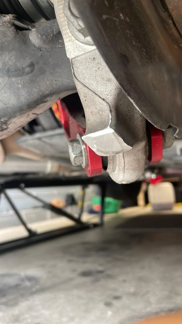

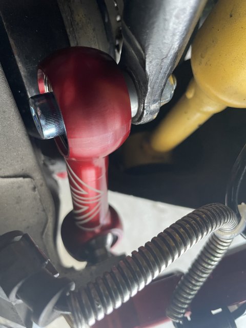

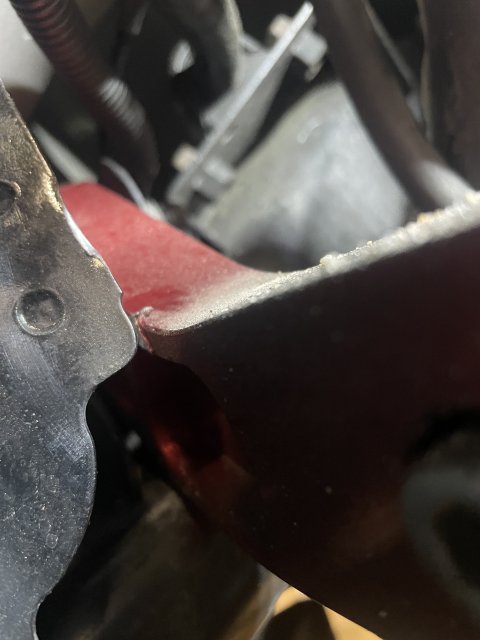

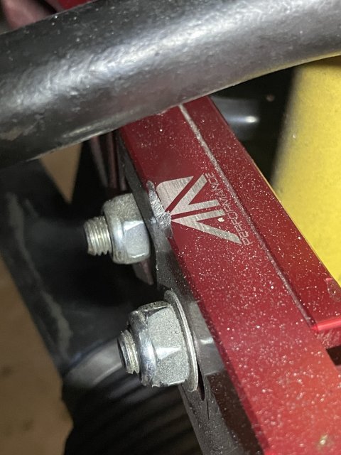

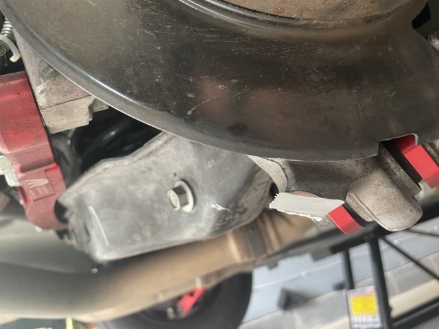

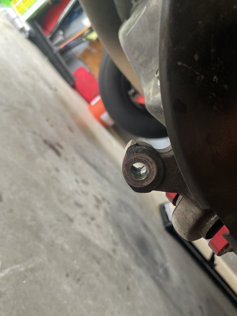

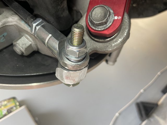

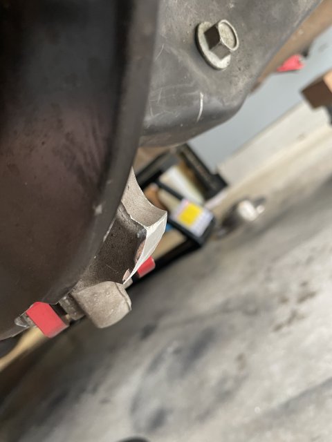

Also forgot to add, went home, took a fucking angle grinder and hatred to the knuckle
AD3B1E97-7F7D-499A-9312-6464698953C4.jpeg 7DB341FB-F164-4E17-BEE6-6D58C3A72719.jpeg
62,174
217,215
Not sure how you didn't hear any grinding then you did. Tells me something changed. Wheels are hitting the arms, or sway bar?
4,130
10,399
Thread Starter #867
it was the articulation in the sway bar making left turns… anyway those ears are gone… more aad suspension parts…

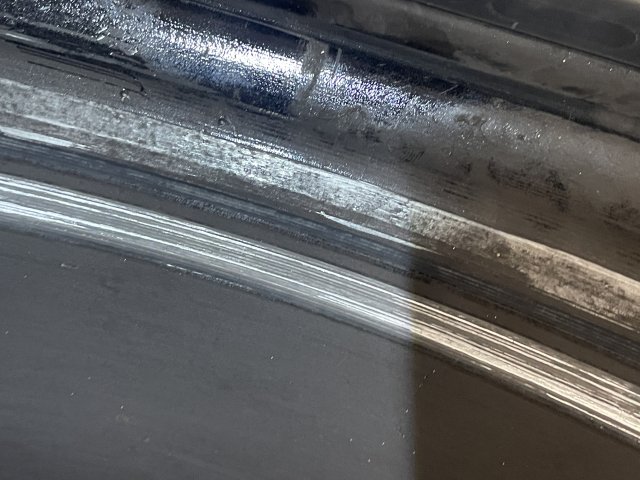

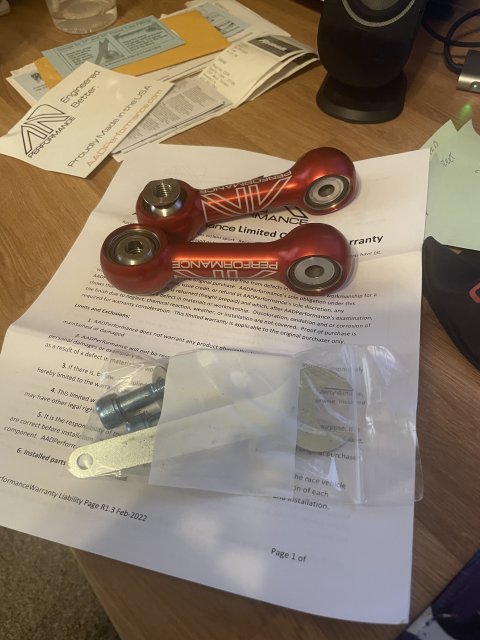

DA6F6046-3BE5-455F-A6B4-AA54DCFE3E9F.jpeg 9B0038E2-21A4-4EEF-92AF-FA55117CA5D5.jpeg 564904BC-9384-485A-A342-A31F44A5D140.jpeg BB9B0AB2-A4D5-4E42-8A74-AA32CAB83DFA.jpeg 455AF49D-A23B-4597-A968-4D8EF4D7DB3B.jpeg 3D625215-1512-493B-B6FA-28B67A618AEA.jpeg 78061E72-9D44-4ACB-B817-B863F7CA6D1A.jpeg

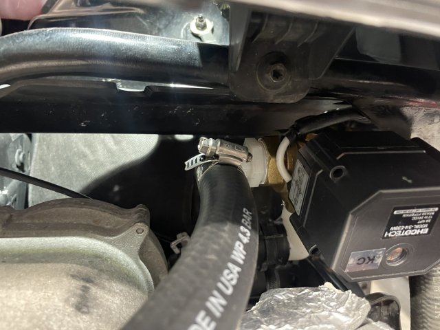

Now to sand the wheel and hit it with some black gloss wheel paint. Still no replacement from Kincaid :( . Using the old unit to mock a bumper mount and redo the lines.

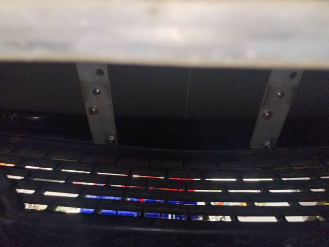

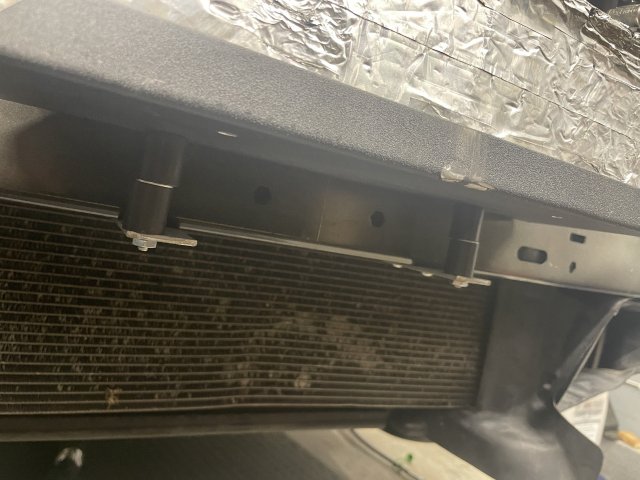

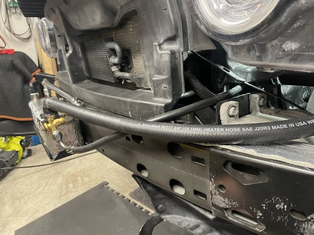

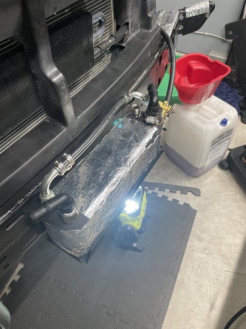

Front mount killer chiller done.
Very happy the existing liquid line worked out to be the right length, have to cut some new ac lines for use but it's late, test fit of the bumper, based on existing measurements of the foam insert it should be fine.
5,210
9,669
More better like that. I notched out my bumper support to recess the chiller some.
FYI - those curved end pieces on the bumper support can be taken off to save a little more weight, I did with no issues.

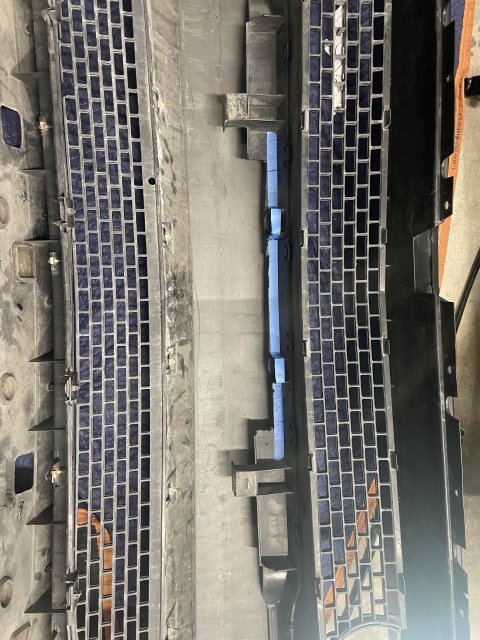

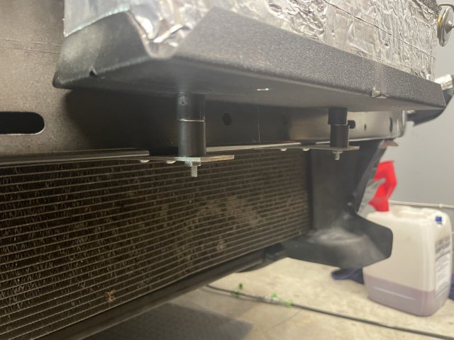

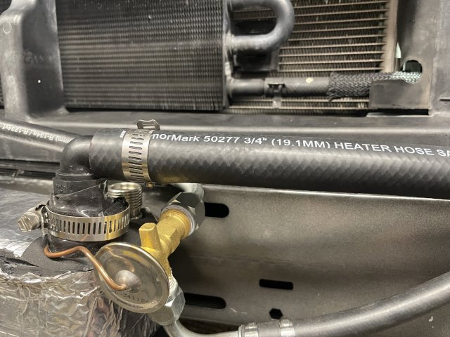

Have some motivation. Some guy in a M5 called me slow. I now got to dunk on his ass. Front bumper mount for KC done. Figured out the spacing and did a bumper mod. 😁
E43DA9B9-1961-4386-B4D6-E1C433471473.jpeg 91FE9D98-A842-44AC-863B-BC0D0EF87390.jpeg D5A7F124-2DC1-472B-9FEF-8F964B634C07.jpeg 5C3B0637-8E18-4682-8298-76F7E12C7CEF.jpeg Still dont have a replacement from vendor for KC. Should this delay keep going, will just go buy my own fucking lines and make it myself.

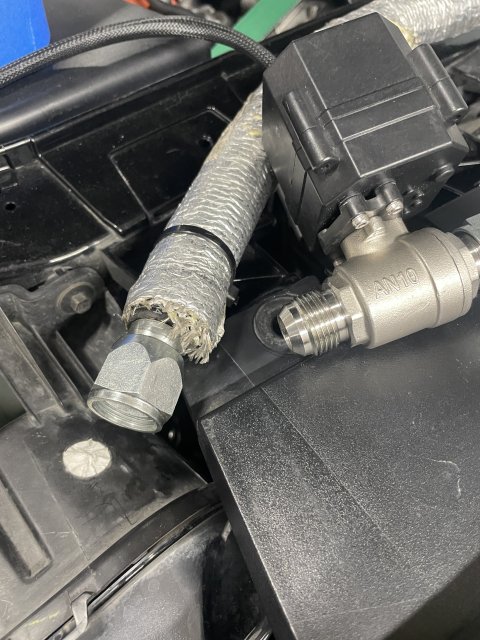

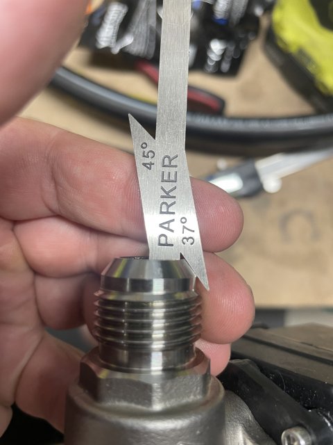

Couldnt sleep, was doing mental math in my head. If you have ever worked in automotive AC all fittings are sae 45* flares. So while reviewing parts from my KC kit I noticed something. He sends AN valves.
no wonder i had a small leak and it reminded me of this post…
https://www.hellcatforum.org/threads/killer-chiller-nib-with-all-options.4720/page-2#post-56822
In which you couldn’t hold a vacuum… ffs he mixed 37* and 45* fittings.
im about to rip it out and just go icebox

Did you use that refrigeration grade sealer on the flairs I suggested back when you where doing your installation? My system is still fully charged 3 years now and still produces 26-28 F coolant, never had to mess with it since installation. When you pull a vacuum and if the vacuum doesn’t hold overnight and gauge stay rock steady where it was, not for just 10 minutes or even an hour you have leaks and need to address them before charging or your system will not work right for very long.
For AN fittings it is heretical to apply anything to the flare as that will compromise the integrity of the flare as the connection is mechanical compression. 37* fittings should never be mixed with 45* fittings, ever, the sealer is a temporary stopgap. In your instance it has worked flawlessley, knowing my luck it will leak like a mf’er.
Im saddened by this cause still no replacement parts, this issue is now apparent now demotivated again.
I agree, the 2 should never be mixed but some fittings these days are dual flaired to fit either JIC or SAE, they don’t work as well but they will seal. I’ve used these Flair Tight sealing washers with GREAT success, I may have even used them on my install I don’t remember as I do have a assorted kit in my shop. Maybe you can get some of these quick and use them? Get the refrigeration grade ones.
https://www.flaretite.com/shop/flaretite-seals

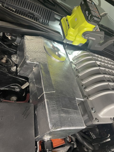

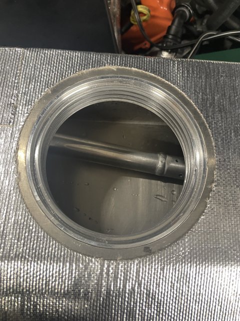

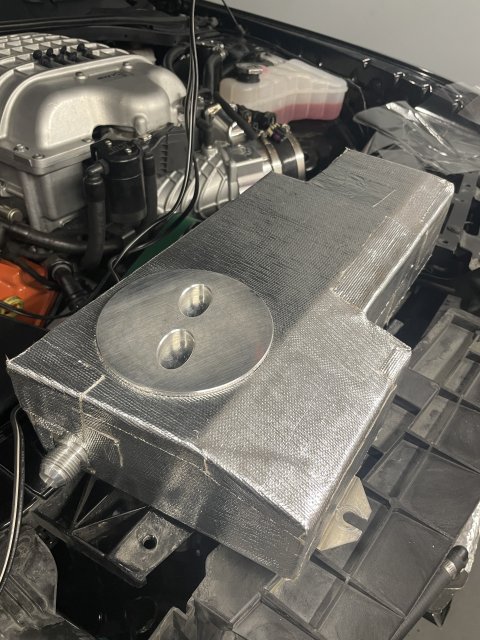

Parts shipped, finally! 🥲 Wrapped the BMR tank in something better.
145D10B9-9987-4BDF-8731-2275859FD955.jpeg 0C76FE0D-869B-4CB3-BB09-A37EC49D7D58.jpeg 58397C8E-20E7-467D-A351-EB5F59E7FBAB.jpeg
picked up thread sealer/flare goo.
