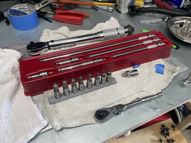

Added some 1/4” drive tools to the family.
Sooooooo much room, took 10 minutes

Where'd you find them? 👀
Home depot for the 1/4" hex drivers. Husky brand. For the extensions, Harbor Freight, ICON brand. 1/4" Drive torque wrench is Pittsburg. The flex head ratchet is OEM tools.

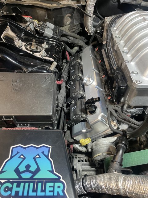

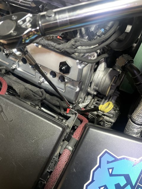

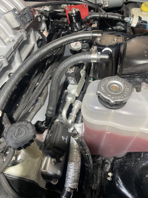

Just got done with drivers side. Making my new AN lines for the catch can. Easy day. This is what I was referencing @vortecd for space. Also use a mirror and inspect your gasket before and after torque sequence. Final result at 97in. Lb.

Semi buttoned up. New an lines on driver side. Spent 48 hours thrashing, wouldn't have it any other way. Time for bed, gonna do the coolant side during the week.
