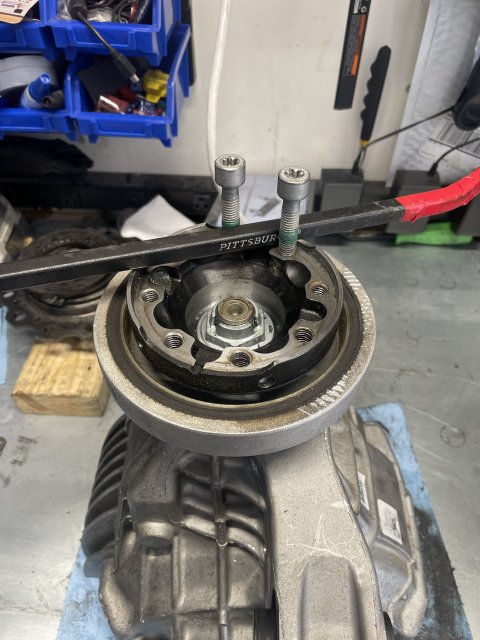

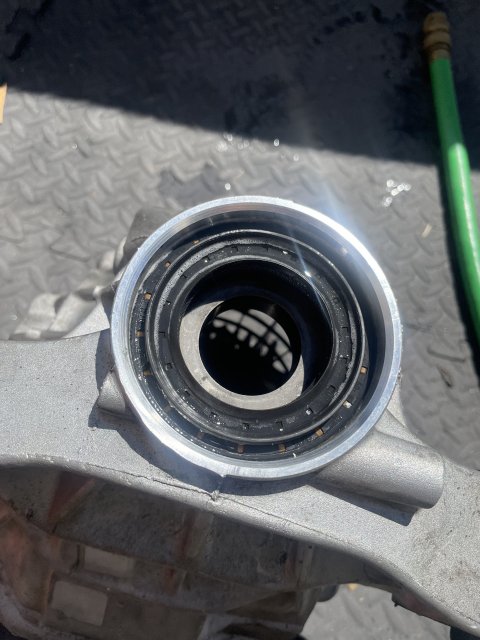

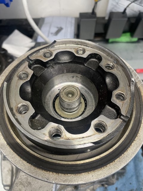

old diff bolts and a pry bar, 32mm impact socket and ugga duggas. IMG_8909.jpeg

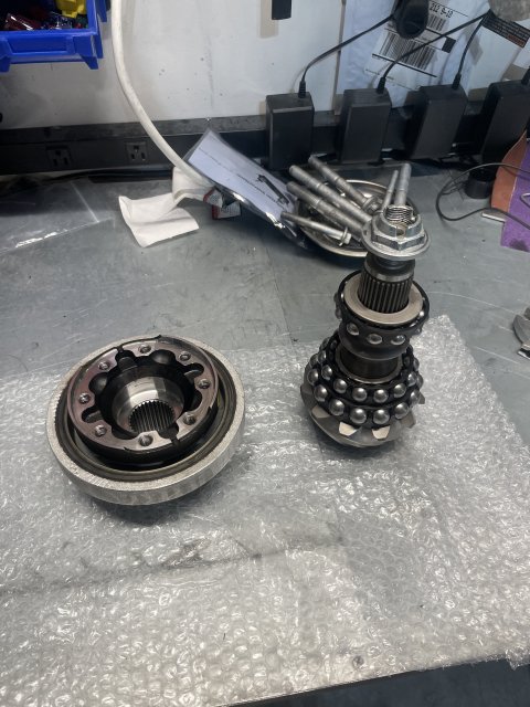

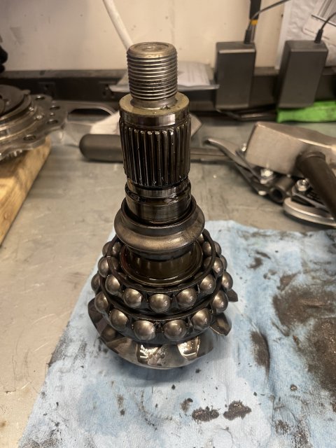

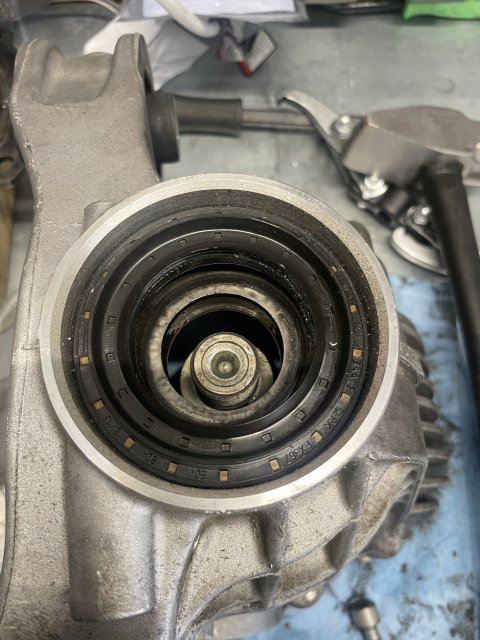

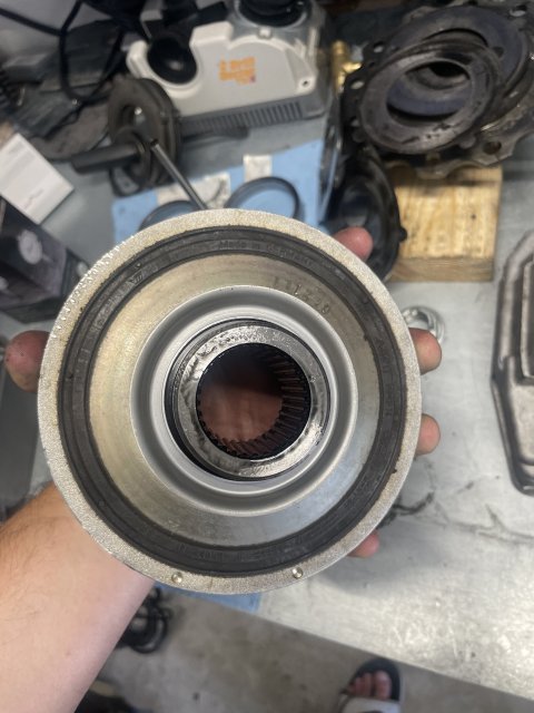

Dirty hoe, simple green and brake clean, high af after 71657589531__9F9D5E94-3863-4C5A-BEE4-2D91D1FDD5D9.jpeg

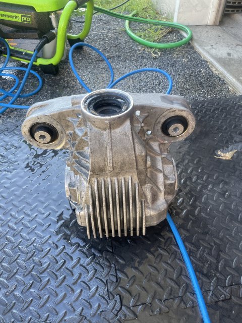

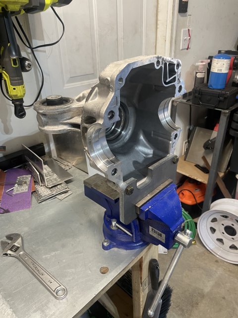

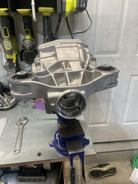

In the kit comes a setup plate, bolts sourced out of the fuck it bucket IMG_8931.jpeg
caution: do not use brake clean on the pinion flange, pressed rubber bushings you cannot replace, pinion was inspected, all bearings good, all machined surfaces good. IMG_8935.jpeg

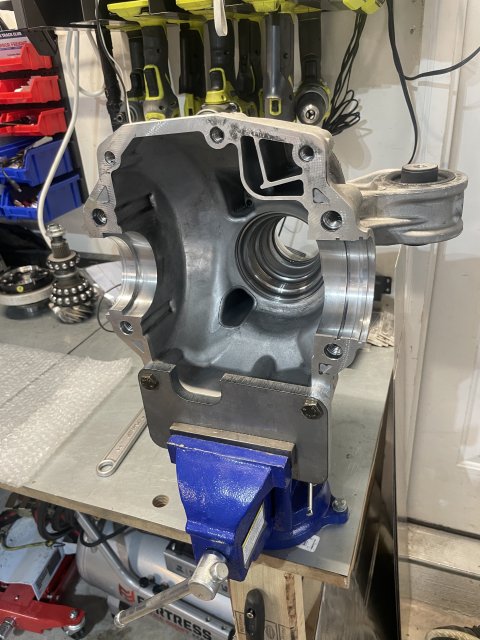

Pinion gears are sharp, need to pull the ring gear but thats a tomorrow me problem, time to go get beer

Thats a hell of a beefy bearing arrangement there on that pinion assy!!!
It is, pain the balls to clean. However they spin freely now, was having an issue where it was binding before cleaning, think there was a ton metal in there. There are no specs on ZF diffs so its going to be trial and error to get backlash correct. I have numbers from dusterhoff and will confirm on assembly. Need to pickup seals on Monday.
Okay now I see why there’s no aftermarket dang

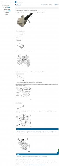

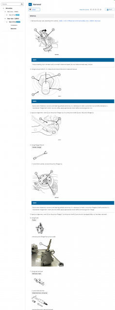

So I did find this documentation on the pinion flange removal and installation to repair the seal. This helps me with re-assembling that, however I didn't mark any orientation as I was cleaning out metal so that was more of a priority. I wonder if imbalance will occur. However if you install this into a billet housing there's no way to keep track of that so, by reasoning maybe its a herring???
this is for re-assembly
My mind boggles at this:
"If the pinion nut alignment index mark exceeds the pinion shaft alignment index mark the unit must be discarded. If the pinion nut alignment index mark falls short of the pinion shaft alignment index mark the unit will possibly generate an Noise, Vibration, or Harshness (NVH) concern."
Knowing this I would have just bought a billet case and said screw it with these housings. However I don't think this will be an issue, we shall see.
so let me get this straight. They’re marked from the factory (maybe), and if you can’t see the mark on the pinion flange and the nut, you’re supposed to make your own index mark before disassembly to mimic factory “torque”. Is there no set torque spec for these??? Blows my mind too. I guess that’s how they get around telling you the torque specs? Then again they also tell you to index the driveshaft before you take it out I haven’t done that and I’m fine, maybe I get lucky but that doesn’t have anything to do with torque indication like this index mark would

Calling in the big dogs @Hatermkr do you have any torque values for the pinion flange nut?
there is no torque for the nut, you tighten the nut till you achieve bearing pre load. tighten in small amounts till achieved. do you have the spec for pre load cause I couldn`t find it anywhere but I had no reason to take my flange off when I did my wave track. brgs. felt smooth with no end play.
