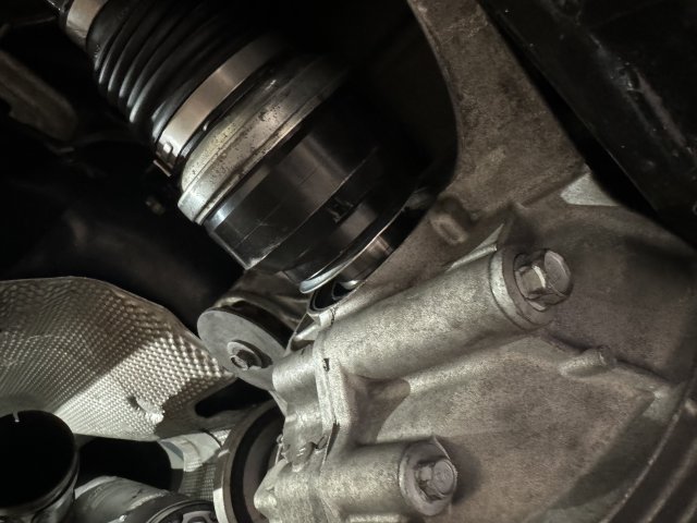

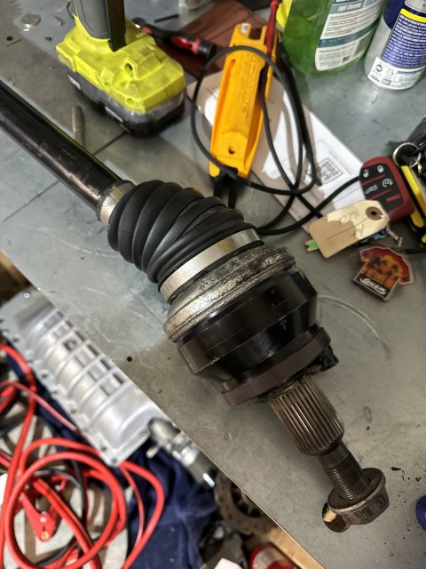

Can’t believe this thread made it to 99 pages. I am happy to say that the car is retired. This is how fucking much this car hates me.
Axle is toast while trying to get it in then on the driver side, the diff would not seat the other axle.
had a little bit of a mental breakdown and just asked my friends to help me out.
more axles, same diff (2.62) and she now drives under her own power.

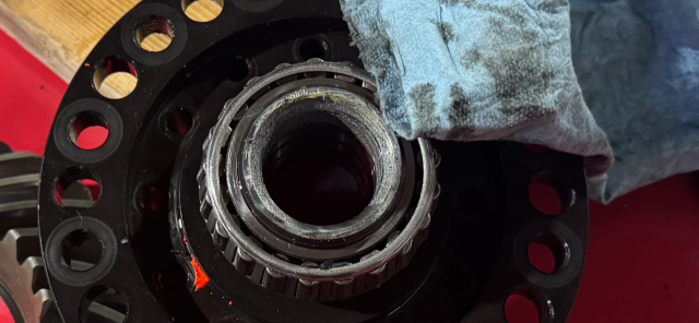

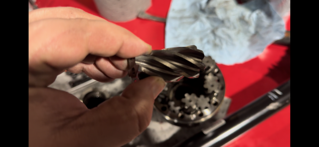

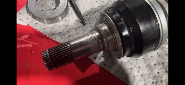

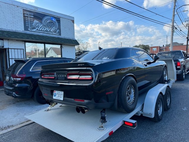

Final post I'll make to this thread. Wavetrac update:
The carrier has been sitting for a few months, I would literally look at it and curse it and just stare at it and walk away. Finally said I need to make room and took it over to Starcks performance as I would need a press to get it out of the carrier. Disassembled the carrier, none of the wavetrac gears or internal components are at fault. The demon axle somehow shredded itself in the carrier then welded itself to the carrier as that's why I couldn't get it out.
it will be shipped out to wavetrac for repairs or placed in the graveyard of 3.09 parts, all based on what HHP or Wavetrac want to help me with.

That’s insane. Any splines twisted?

Wow i somehow missed this post. id be interested to see if either the axle or bearing tolerance were off on either. the splines look good. very odd spot to get seized in the bearing like that? possibly a small piece of debris or something got between them and got it hot enough to lock in there like that.
