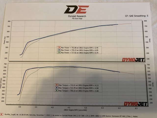

So I realized that I forgot to update this thread:

You know the drill, good gas, no traction control. When we did my ‘15. We did three pulls. Street, sport, track. For whatever reason, the last pull in track rang the bell over the others. 6th was over 190 mph at redline with the lower numerical gear on the ‘15. I don’t remember which gear your new RE has.

This was a 5th gear pull in track mode(150 mph on the dyno), transmission in M mode and on that third pull we did take it up to 6500! :)
My car has the 2.62s

There is why the bottom line power was a bit high. It was multiplied a bit.

Never been a dyno guy about numbers but still fun to do. Best to do it with some others to compare same day and dyno

Indeed, I only did this because it was a local Challenger club day and our track never opened this year so I was itching to do anything with my car LOL Everyone else was reading very close to where they should be, 392 Scat Packs making 420 rwhp. The shop that was hosting is doing a redeye build for a customer and they asked me what my mods were done to mine and I was like no she's stock. I asked them about doing a pull in 6th gear and they said it would probably read the same...anyway, whatever a dyno pull is just that. My car runs great, pulled away from my friend's brand new 2020 redeye, so maybe she does have a few extra ponies :)

I'd say the dyno guy doesn't have a clue. You should always pull in 1:1 gear, 6th for us.
