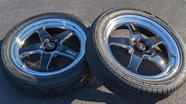

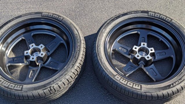

Wasn't really trying to go, my racing days are over. Might want to look into a skinny for the front to drop that weight. Might want to look at at a 104 or e85 tune, @Jon-MooredPerformanceLLC can do that no problem. If you got with a small pulley up top, definitely will need supporting mods.

to my knowledge there are no skinnies out for the 2018 up (whatever year they went to slightly bigger brembos). i would want to try to stick with 93 just for simplicity sake because i drive my car. if we get e85 local to me i wanna go E though. i wasnt sure if a 2.85 would get me to 10.00.

They make skinnies for your years. I have a pair on deck if you are interested with tires.

I thought they didn't make skinnies for the '21 up cars with the bigger brakes?
3,552
8,654
Atleast im not crazy, cuz thats my understanding too

They gonna be waaaay out my budget. Lol. I got a steal on my welds for the rear at $600
