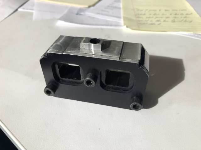

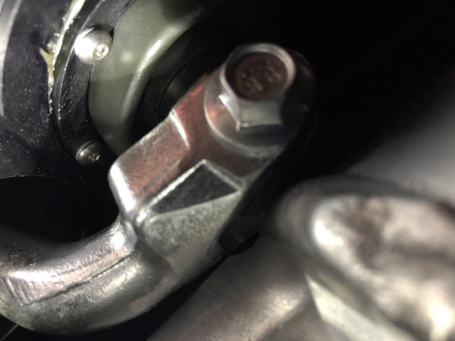

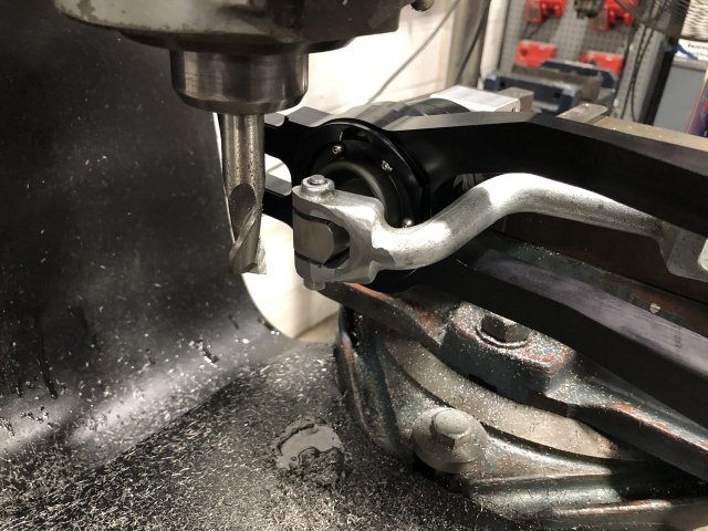

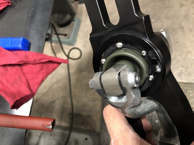

Nice work! What did you have to do to Barton to fit? Grind to clear u-joint coupler? (pics?). No mention of vibration with this driveshaft. Assume all good. Good luck with this setup, hope all comes together for the better when weather permits. Again, (y).
Yes, Barton hitting right where the yoke is welded to the tube. I machined off the bottom of the Barton linkage and connecting arm and also had to take as much off the rear mount as I possible, have about 3/16” clearance now and no issues.

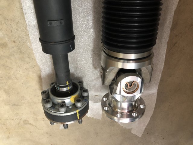

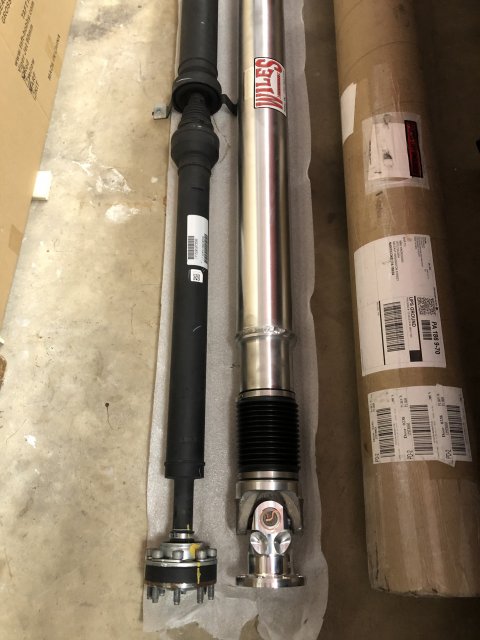

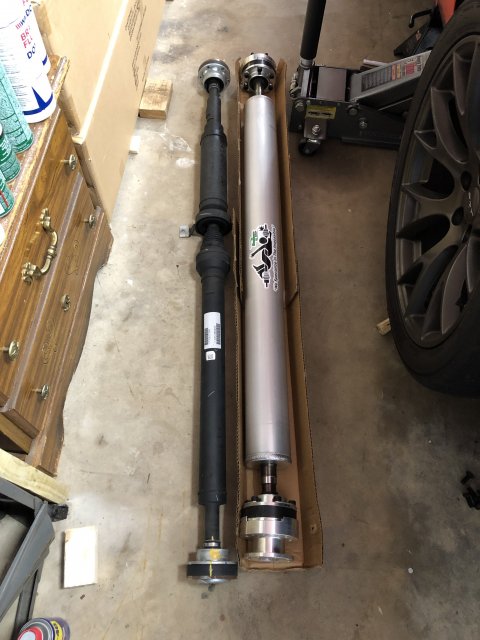

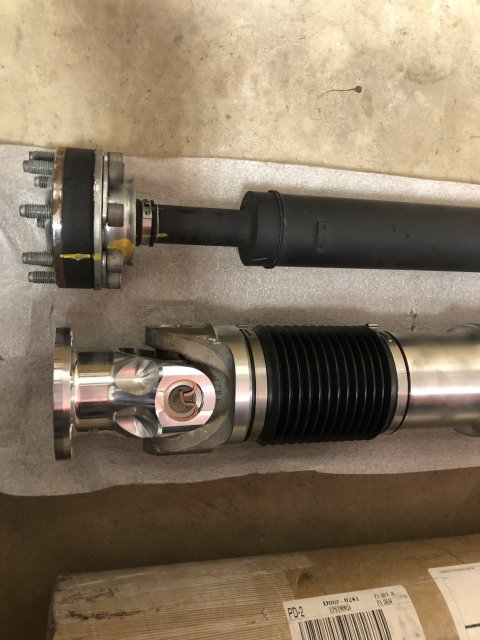

And yes, happy with this Wiles DS, no vibration , really can’t tell the difference from stock shaft NVH wise. It looks the part of a 1200 HP rated shaft. I sent a bunch of pictures and info to the owner of Wiles and he is going to try and come up with something possibly so a Shaft clears a Barton as a bolt in.
Here’s pictures of the DSS vs stock shaft and the Wiles vs stock shaft, which would you pic based on just looks alone?? I have no worries DS wise now.

View attachment 5848 View attachment 5849 View attachment 5850 View attachment 5851 View attachment 5852
WOW. Very concise and VERY clear. Thank you. It's guys like you who do it 1st that make a decision a whole lot easier for guys like me who decide if and when to make the right decision. Thanks again.
P.S. besides looking bad ass and strong that DS looks like a prop from Star Wars. LOL
