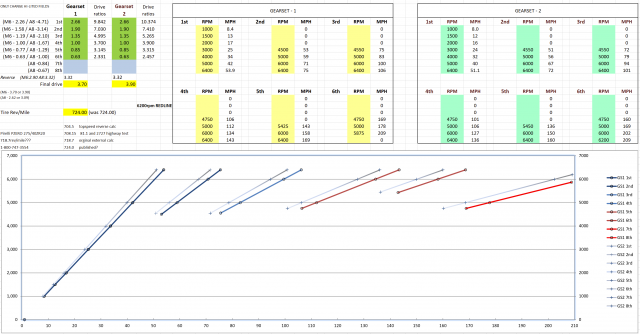

What is your redline?

I shift at 66-6800, been to 7200 at times, especially in 4th.

Maybe you already have it, but in case not, and you want it, I can send you the sheet to fiddle with if it's of use.

Thank you, I’m good though, I use an online gear calculator that’s pretty quick and slick. I know what my speeds are per gear already. I just was wondering if a different rear ratio may help tame torque some. I think there’s a Calculator that you could input torque and horsepower curves on along with gear ratios, cars weight, etc I’ll have to look for it.

Linkage if you find it.
