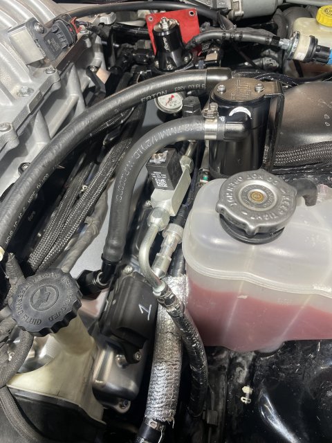

Weld a 10 a fitting to pump and put on a remote tank. That’s how the old 6.1’s are
yup, could just buy the 6.1 pimp and use a remote reservoir. I got it modified to work with my power steering.
I have all of that for sale for cheap and no one will buy it.

Sorry for the dumb question, but is this mod primarily done for aftermarket blower fitment, and secondarily for some valve cover brands it appears?
Yep, exactly. I’m selling a hellcat pump with a remote fitting on it, not a 6.1 pump. Tank is from a 6.1 or 6.4, has the correct feed and return port sizes that will work with hellcat lines.

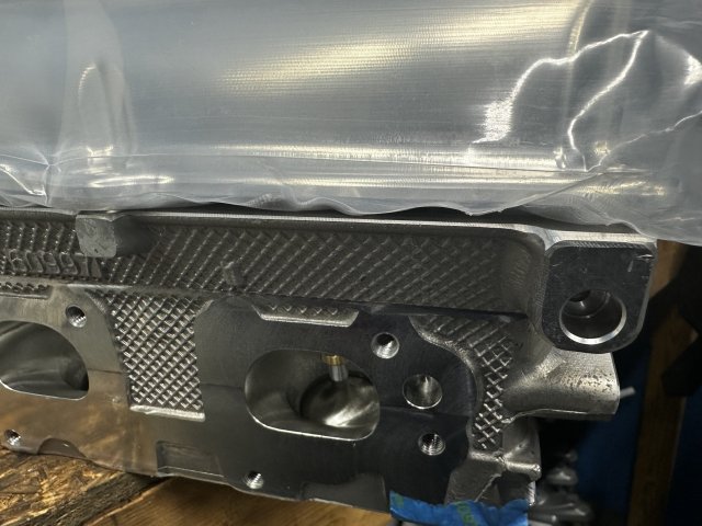

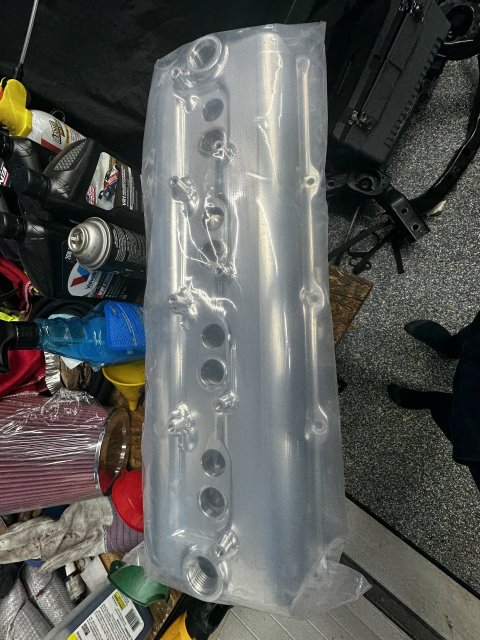

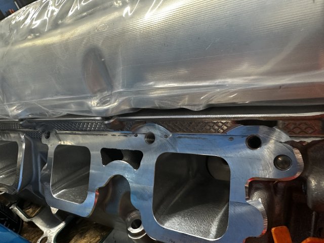

I had to modify my new Cornerstone covers to work with the power steering. I haven't seen any kits to eliminate the power steering on a hellcat yet.
Robert, What portion specifically had to be modified? I have the Cornerstone covers but no plans to have HHP install them until the new block is finalized.
Any pics of what had to be changed?
RGPIII
#983
994
1,832
Bridgeville
DE
the front edge needs to be milled down pretty significantly. I've got the 6.1 pump and remote reservoir ordered.
