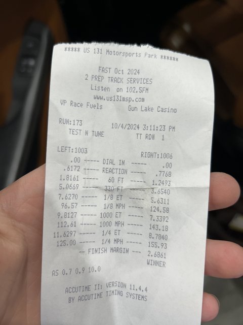

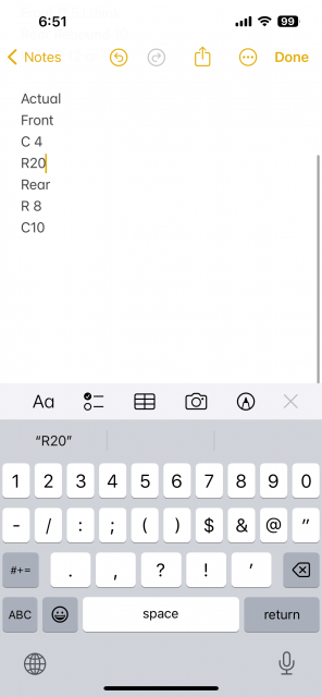

Here is where I landed on some pretty bad prep this weekend if you are still looking for some advise. This was my first time out with them I still have a lot to learn. But this got me down the track when others were struggling. I have a lot more settings to try.
