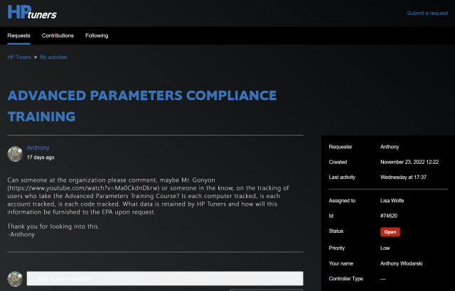

So @Jon-MooredPerformanceLLC got me a MPVI3 really quickly as my laptop days in the car are over. However due to EPA shenanigans and their refusal to answer a support question, I will refuse to to tune with the device. My MPVI2 and beta 4.13 work just fine in that respect. The question I asked:

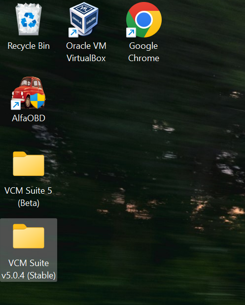

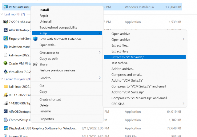

Well this isn't my first rodeo, don't want to use the MPVI3 for tuning anyway and don't need to. Although the MPVI3 will work with beta 4.13. At best it is janky. However I don't want to install 5.x over any of my existing software. Enter my experience as a pen-tester and exploit writer. So the installer is nothing more than a self contained zip file that drops the files into the correct location. You can use 7z to extract the contents to a folder.
Since this is still an archive that would have been installed and renamed you have to rename two files and exactly as follows.
"VCM_Editor_exe" => "VCM Editor.exe"
'VCM_Scanner_exe" => 'VCM Scanner.exe"
I dropped these folders to my desktop and named them appropriately.

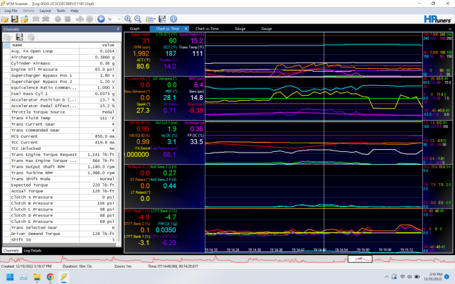

9.) Save to location and do your thing. I opened the log in the Stable v5 branch of VCM Scanner.
