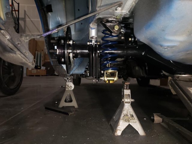

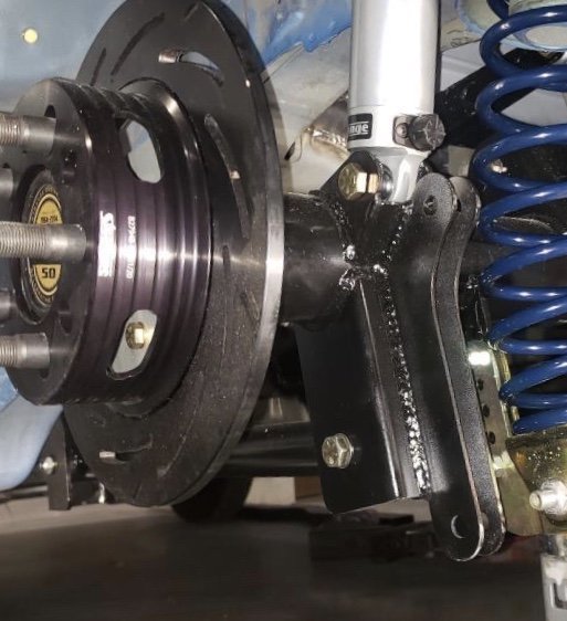

Hmmm... what’s this I see 🤔 429CD70C-BC66-4253-B7B5-EF1AECA16DB3.jpeg 9B3CC2EF-AE86-4907-B58F-8D75A2CBF5D7.jpeg

There are so many incredible builds going on right now it’s just dumbfounding. That’s a friends Redeye just completed. Another one of the shops cars has just decided to follow instead of going with the 9” IRS. The writing is on the wall. I always wanted to go that route but didn’t have a clue on where to start. Not any more. One of the things that will alway be a struggle is traction. The heavier the car the worse it is. I’ve got a transbrake and a 2-step and I’ve been warned not to use it. The CVs in those axles won’t take it. Super prep and we look good in spite of the IRS. Anything less and it’s a struggle. That is the answer to that. And yes.... I’m stirring the pot 😂

Wow, eye candy in deed! Does anyone make a kit for that? I think someone could make some money offering a well engineered kit for both a Dana and a 9" Ohhhhhhh BABY!

Yes actually they do. MPR Race Cars in Michigan. It is the actual Drag Pak setup and it can be purchased as a kit just like the DSS Conversion. They can do the install or leave that up to you. The one in the picture is a Strange custom 9” Pro Gear with 40 spline Spool, gun drilled axles and Strange Brakes. Everything needed to install in a current Challenger is included. The one pictured is in a Utah based 2019 Redeye out of SpankinTime in St George/Hurricane. We are in the process of getting one of these for Joe Padilla’s red Demonic Hellcat out of the SRT Autoworks shop in Phoenix. We’re planning on the install being done by Carlin Fabrications in SoCal. I’ll look forward to running one next year.
