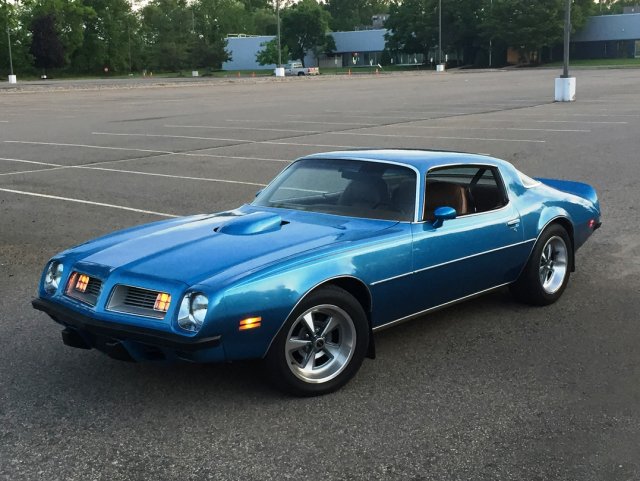

I think my world record battery life award goes to the AC/Delco battery in my grandmother's 1975 Firebird. That battery has been in that car and starting it every year since 1995! It's insane. It helps that the car has nothing to drain it from a trace charge, like an analog clock, but still. That's nuts. It's probably my Gramma Rose looking out for us (and her old car: she bought it new in '75). :)
Sealed battery? If not, were you/she using distilled water? Maybe the NJ tap water had some extra zip in it! ;)
