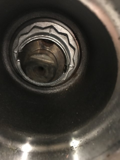

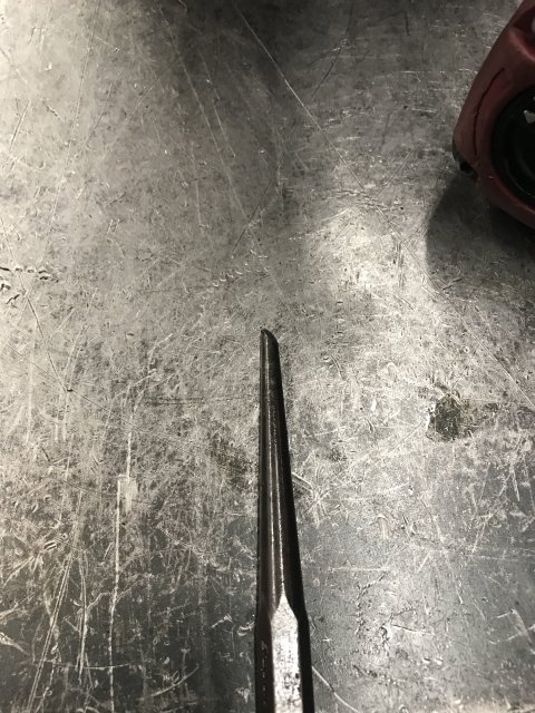

The rear output flange will need to be removed as well use the punch to get the locking tabs on the nut bent out before removing it so as to not damage the threads

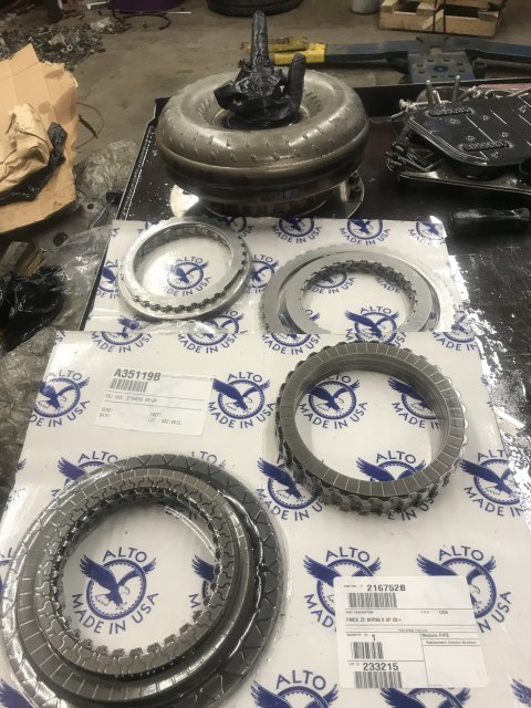

This is the alto clutch and steel modules that I will be replacing my factory ones with 77CD9CBC-41D5-4B00-BEDE-F23FBAD0F2FF.jpeg

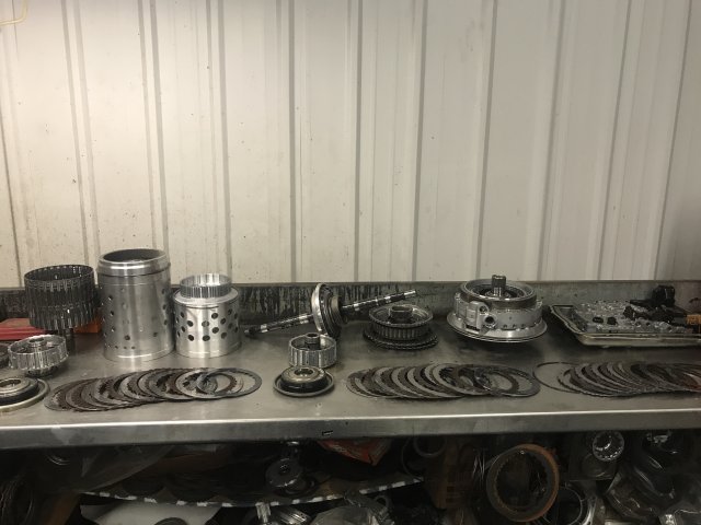

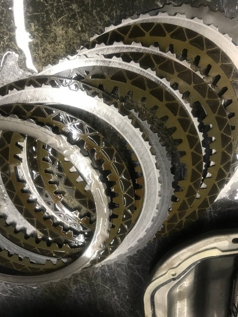

Here’s the pics of the A and B clutches
They still look new no damage or any signs of slippage first is A clutch which is housed in the back of the pump 2nd is the B clutch which you see still in the housing and then the clutches with steels are laid out on the bench 8B916323-CB2D-427B-ADB1-5C2886B2178D.jpeg F9A218D4-7ACD-426E-B4C8-396C8F6F6B7E.jpeg EB690E0B-FF4D-4C16-BA1D-5B92138F041D.jpeg AD6770F7-D8AD-48FD-9797-A5726D578A20.jpeg

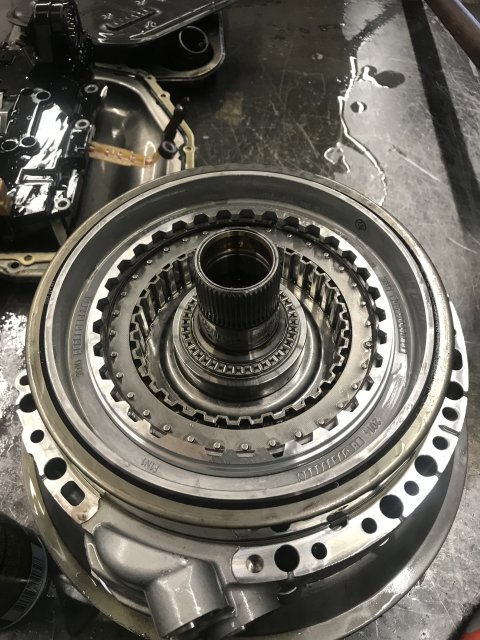

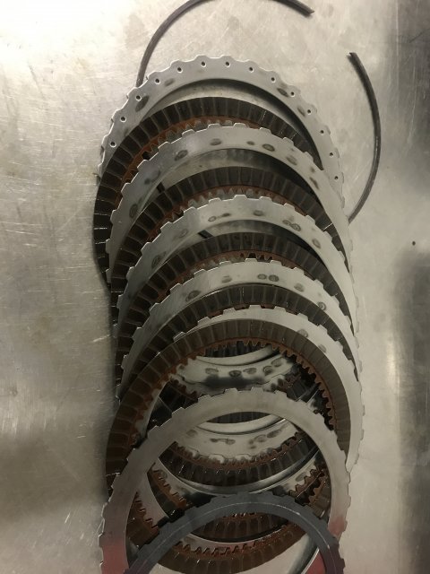

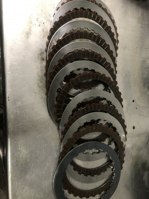

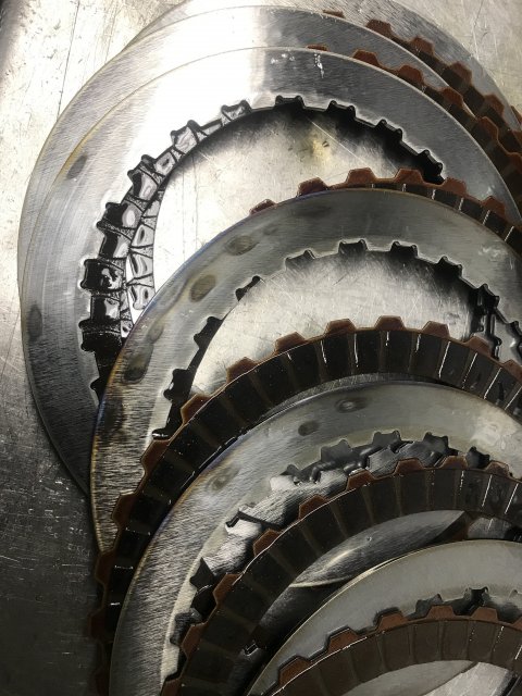

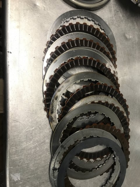

On here is the break down of the c, e and d clutches as you can see the E and D clutches have definitely been slipping the c clutch is ok as it shows no signs of slipping the order is C E D
AS FROM FROM THE PUMP TO THE REAR OF THE TRANS YOU HAVE IT AS FOLLOWS A B C E D

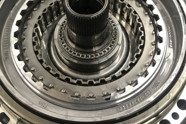

I also added the pic of the housing that holds the c-d clutches and the P1-P4 planatarys BA7372E5-1DD8-4A94-9582-2E147972FABA.jpeg E6727226-B2AA-43E7-B77D-9E4353A60EA6.jpeg 743A3F49-8740-46DE-A7D6-A86B9E49D4E2.jpeg E7B251B7-2A8A-4BBC-B957-5817568F2562.jpeg
11,710
19,832
Nice. Thanks for sharing. Out of curiousity, do you know what the 4 digit stamps around the edge of the housing mean? 2014, 2015, and 2010. There's an F1N1 too. Alignment marks?

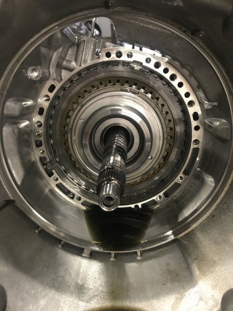

Maybe it is me but those stock clutches look perfect, are you sure that the clutches are burnt? What color is the fluid? It looks dark green which is normal (not burnt).
I love the tear down and photos, please walk us through this, very useful.
Cole look at the e and d pack
The steel s tell it more so then the clutches , now stay off that shine buddy image.jpg image.jpg

Great info... Maybe restall on the stock converter or a redeye new one? Converter plan?

if you look at the steel plates you can see the black heat spots which is to the point its distorting the metal in the plates ,unfortunately as I look at them theres not enough material to cut the pressure plate(backing plate) to add another clutch and steel to the clutch pack assemblies as they are already not that thick
im adding the demon converter
11,710
19,832
What part of the housing are you referring to QUOTE="Magnified, post: 34588, member: 1155"]Nice. Thanks for sharing. Out of curiousity, do you know what the 4 digit stamps around the edge of the housing mean? 2014, 2015, and 2010. There's an F1N1 too. Alignment marks?
[/QUOTE]
See around the edge here?
