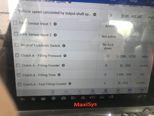

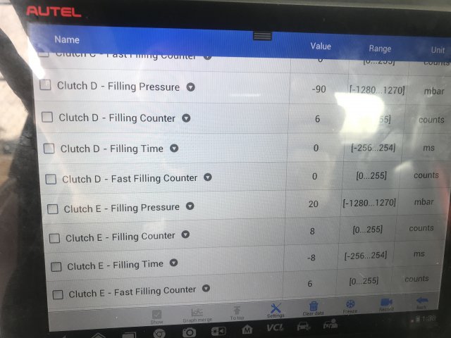

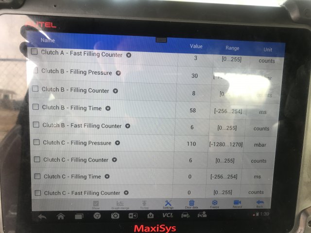

Been driving the car now since Monday and figure I’d share with you guys the clutch fill times and counters that speedy talked about 28BF6416-DE8A-44A3-A4AB-D12E7F6110D5.jpeg 730BCD33-F34C-48B5-A53E-EAA381F268D6.jpeg 46C5B741-CB69-4E0A-9012-3F3ABBE52FB2.jpeg

That's pretty awesome.
What scan tool is that?

Autel maxisys

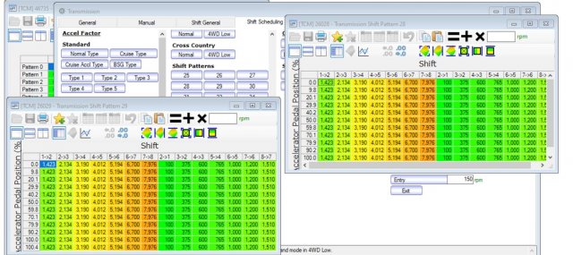

Now, someone needs to figure out when shift ID 28 and 29 are used. These are from a STOCK Redeye calibration! Found the same 6700 RPM shift points in the Demon cal as well. The conspiracy theorist in me wonders if there's some Easter egg deal like paddle down twice, paddle up twice, and hit the brake pedal for three seconds to enable these and that's how the Demon got the 9.65. In the Demon cal they're mapped to a manual paddle mode.
