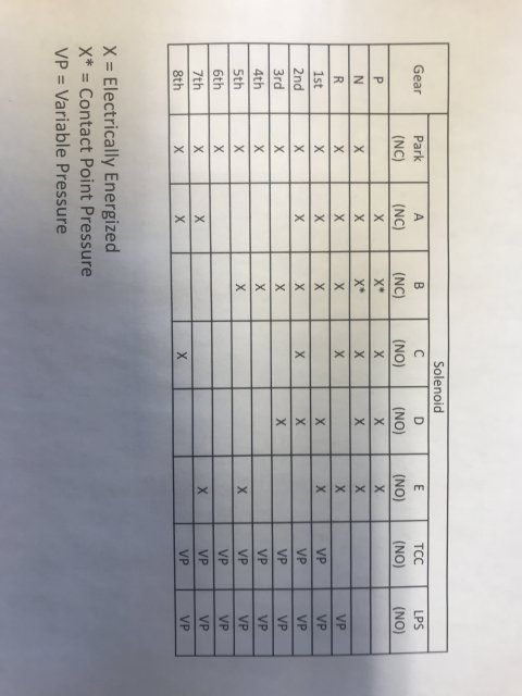

Thread Starter #116
OK SOLENOIDS SHIPPED AND IM WAITING FOR A CALL BACK FROM SOUTHERN HOTROD ABOUT THE KOLEEN STEELS ,FROM WHAT IVE BEEN TOLD FROM ALTO USA IS THAT SOUTHERN HOTROD IS TAKING KOLEEN STEELS FROM 8HP70 AND THE HIGHPERFORMANCE FRICTIONS AS WELL ,ALTO TOLD ME THE STEELS AND FRICTIONS FROM AN 8HP70 ARE DIFFERENT THICKNESS SO APPARENTLY FROM WHAT I CAN GATHER IS THAT SOUTHERN HOT ROD IS BUILDING THEIR OWN KITS AND THE CLUTCH PACKS THRU SNAP RINGS AND IM SURE SOME TYPE OF MACHINING(CNC) THEY ARE SETTING THE CLEARANCES TO SPEC .WHILE I WAS ON THE PHONE WITH JUSTIN FROM ALTO HE TOLD ME THAT NEXT YEAR THEY ARE COMING OUT WITH A BETTER TYPE OF PERFORMANCE STEEL FOR THE HP90 IF I DONT HEAR BACK FROM SOUTHERN HOT ROD THEN IM GOINHG AHED AND REASSEMBLING MY TRANS AND SENDING IT DOWN THE TRACK ,ILL BE WILLING TO BET IT PERFORMS AS IT SHOULD BECAUSE THE GLAZED OVER STEELS AND CLUTCHES NO LONGER HAVE THE COEFFICIENTCY TO APLY PROPERLY ,I STILL HONESTLY STAND FIRM ON THE CAUSE OF MY FAILURE UNLESS NOAH AT ERICSON TELLS ME A SOLENOID IS NOT PERFORMING PROPERLY ILL KNOW THAT ANSWER MONDAY ,GOOD THING IS I FOUND OUT THAT HOLLYSPRINGS WILL OPEN THE RACE TRACK IF TEMPS ARE ABOVE 50 DEGREES ALL YEAR AROUND SO I WILL BE ABLE TO TEST IT WITHOUT WAITING TIL NEXT YEAR MAYBE,,ALSO AS A SIDE NOTE THE KOLEEN STEELS ARE ONLY INSTALLED IN THE C,D AND E CLUTCH PACKS
3,360
5,902
Thread Starter #117
39D84413-98A2-4EC1-882A-97C779B4C6E8.jpeg SOLENOID APPLICATION CHART ABOVE
