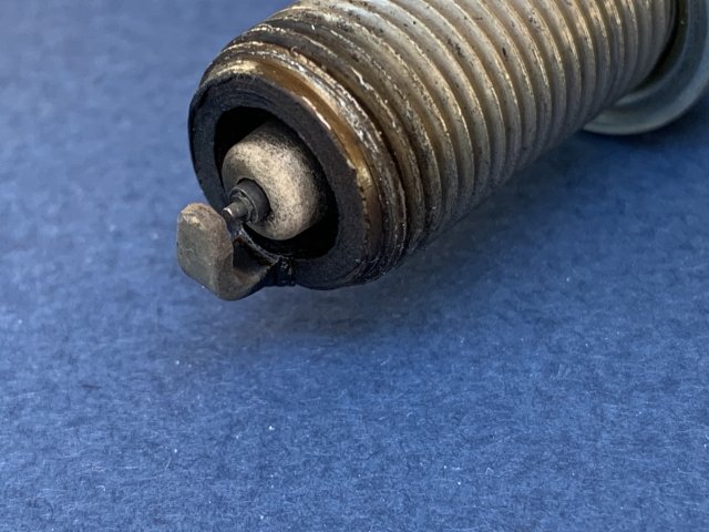

I pulled the #5R plug, seemed the easiest to access. Same type as in Speedy's vid though my gap measured .021". (Speedy mentioned in his vid his tech measured .024".) So it looks like the recall was done and the correct plugs were installed.
Thanks for the help!
