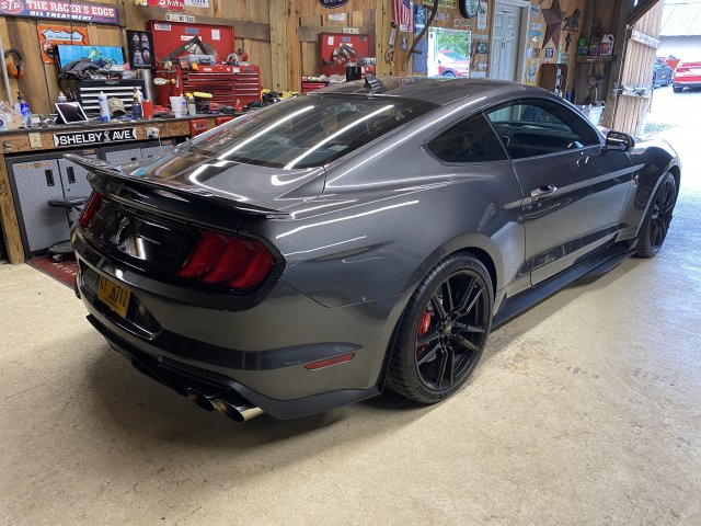

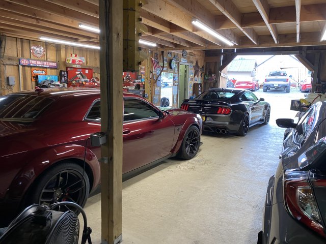

47,798
Then what's the point of having a Challenger? Might as well go buy a Mustang.
Uhm yeah I like it hmm:unsure:
