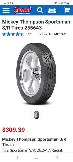

I used the Mickey Thompson sportsmen because of the tread pattern and they are used on many fast cars. They are heavy if that's a problem for you. Wheels were VMS 18x5.
Here it is in 17".

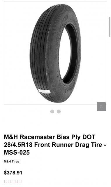

Apparently, m&h has a front skinny that “a lot” of people are running, but they don’t provide a load rating if to anyone. I run the ET Street Fronts, which are super light, 32 lbs with wheel. But I’m over the weight limit on them

And $390 for the 18” (28x6). Insane the price jumps so much
